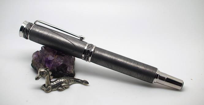

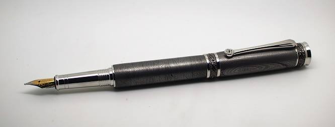

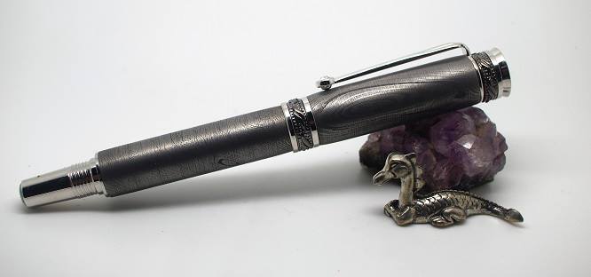

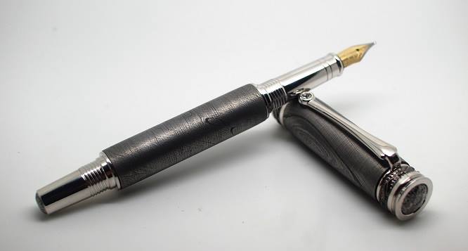

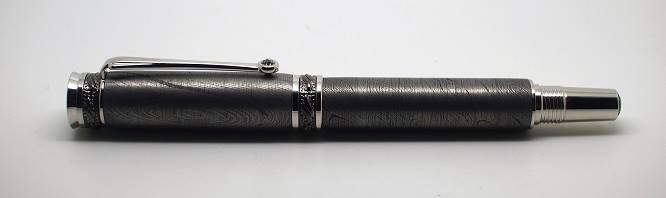

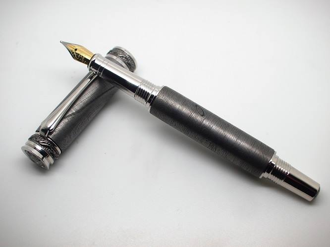

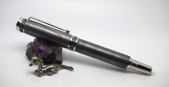

A genuine hand crafted Damascus Steel , Black Titanium and Rhodium Majestic JR Fountain pen.
