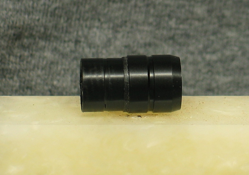

I used the rollerball nib from a rhodium JGII kit on a convertable RB/fountain JSII pen for a customer so I have an extra JGII coupler you can have if you'll PM your address. I've had some problems with "stiff" threading on some JGII couplers and this is one of them so may not be much help to you. Strangely, some JGII RB nibs thread in smoothly so you may get lucky.
Photo of coupler you can have if you want it....

A word of advice (I hope NOT to sound "preachy"):
When the Jr. Gent comes to you, the cap centerband is threaded fully onto the nib---so we KNOW it fits, before we try to assemble it.
I suspect these are getting "squished" because they fit so tightly into the tube (to make the cap). So, please be sure you have NO glue in the cap, before pressing in the coupler!!! Another possibility would be to sand or file (or gun brush) the inside of the tube so the fit is not so tight. Then, put a little Loctite on the outside of the black "thread" piece.
I assemble with a one ton arbor press---the pieces WILL go together, I have the POWER!!!!! But, this could compress the black piece and make the upper threads useless---so it will turn the full turn onto the finial, but will NOT turn the TWO full turns onto the nib.
As I tell copier repairmen that work for me---it worked when you arrived, it doesn't work now---what happened to make it STOP working!!
The above is my "guess", backed up by my own mistakes.
FWIW!!
