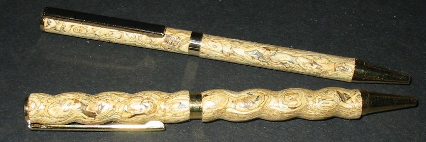

This material came from a sheet of 3/4" thick Dakota Burl. It is made with wheat straw in the middle of the sheet, then layers of sunflower seed hulls are pressed on each side. The straw is too much of the sheet, so I resawed it by saving as much of the skin as possible. I glued the skins together to get a light 5/8" square blank. This stuff is really "chippy". I thought the black palm was bad, but this stuff is worse!!! I used a skew to get within a 1/32 of the final dia., then sanded the rest of the way in. On a couple of pens I had to glue hulls back in to fill the voids. One pen was turned, the other spiralled on the Legacy Milling Machine.

I've turned a few pens from dakota burl and did not experience what you described. It turned very nicely and polished to an exceptional finish. The mfg of dakota burl also makes another product similar to dakota burl from wheat straw. I think it is called bio-fiber, or bio-fiber is the name of the mfg. I have not turned the wheat product. they also make another product from shreded newspaper that turns nicely and looks good. It is called environ and comes in three or four colors. I have seen counter tops and table tops made from dakota burl and it really looks nice on large surfaces.
