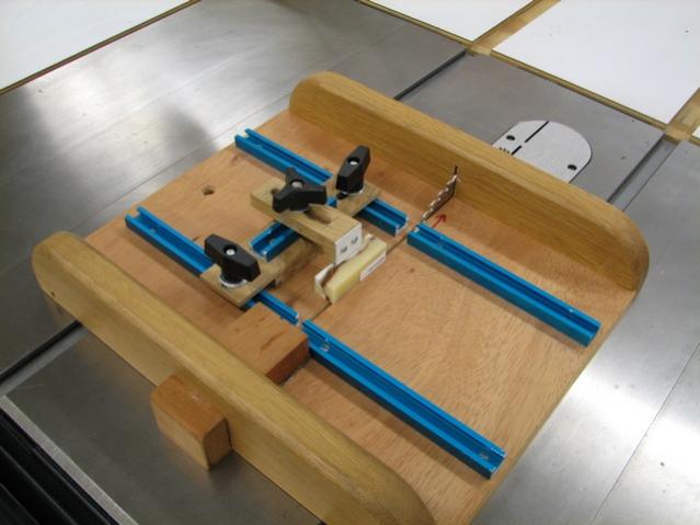

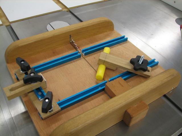

Here's what I use.............
attachment.php
attachment.php
It's made from scraps I had lying around the shop. I can clamp stops anywhere so it's possible to get paper thin pieces if I need them. I have several more hold downs and angle jigs that I didn't photograph. I just use pieces of 1/4" hardboard to make angle jigs, just cut the angle you want, clamp it down and hold your blank against it. It's fast and easy.:wink:
