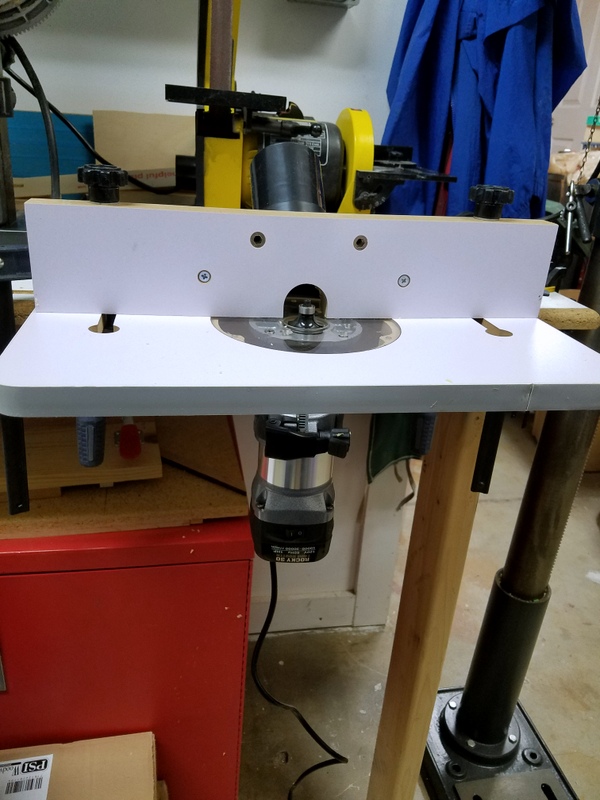

I round the corners of planks with a trim router from PSI. Same thing as sold by Rocklers or on Amazon. Cheap and quick.
