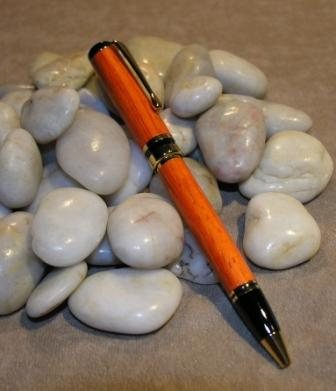

P.S: by the way I will post my first effort at turning .... What a fun week-end this has been
Pierre-Michel
Mar 26, 2007
7
Montreal, Quebec, Canada.
Here it is !
I ask for your indulgence at this first try !
<br />

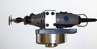

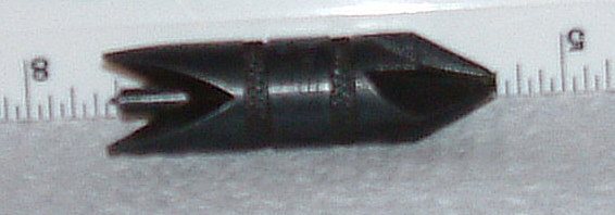

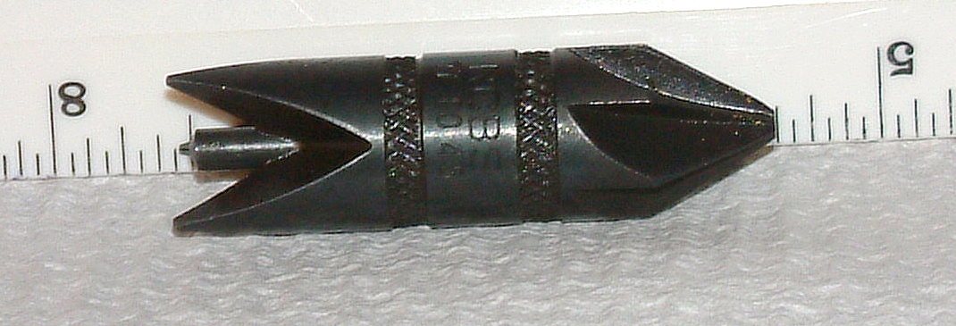

Pic enclosed shows how I use a dremel tool to cut brass cartridges and long brass tubing,you could make a tool post for your wood lathe.I also use a cheap 3 wheel bandsaw that has a metal fine blade and it is dead easy as well.A quick file and light ream and face the blank on a sanding disk followed by the normal facing tool.If this sounds time consuming see the difference attention to detail makes.
Cartridge reamers do out and inside as pic shows.
