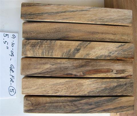

Cutting Pen Blanks
My three main cutting machines are 1- chain saw, to cut logs into managable size to cut into 3"X3" square blocks on my -2 Delta 14" bandsaw with a 3/4" 3TPI blade and the my 3- Delta Unisaw with a carbide tipped sawblade. I have cut probably thousands to 13/16" square X 6" long that I sell on eBay, (Username Deltakong), and also here in the Individual Classified section.
Example-
