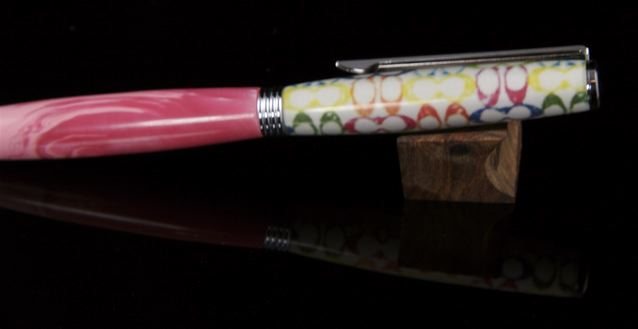

Yup. labels are the way to go. While a lousy photo here was my first cast:
bottom blank is from "Jeff in Indiana", top half is my niece's favorite "brand". This pen was a gift to her on her 13th birthday.
