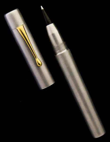

Finished it this morning after working with it on and off for a few weeks.
It's for my son David (OldReg) who wants a LOL...."indestructible" rollerball.
I want to thank Mike Roux (bluwolf) for help with cutting tapers. Comments and questions welcomed. Most of all thanks for just looking. Doc:)

Pete, Thanks. I don't really know much about the different alloys :redface: so I just went to shop and got one end of the rod. The sticker on the rod says Aluminum 6061 T6511 Bare Round Extruded 0.625". It's not anodized..used Paasche Air Eraser at 60 psi with Aluminum Oxide for finish.
Very nice! Did you do that on a wood or metal lathe?
John, Thank you. I used my Micromark metal lathe for all of it except for sanding and merging taper steps/lines on section. I primarily use the wood lathe at that point because I don't have a dust collection system on my metal lathe and I can more comfortably use higher speeds to sand than on my metal lathe. Also..I used taps and dies and did not cut any threads using the metal lathe.
Great! I really like that pen, Doc! You did that on a metal lathe, right? I think it can be done on a wood lathe too, right? Man, that pen really appeals to me.
Robert, Thanks so much! Did it on metal lathe...except the steps I mentioned to John above. It can be done on a wood lathe.

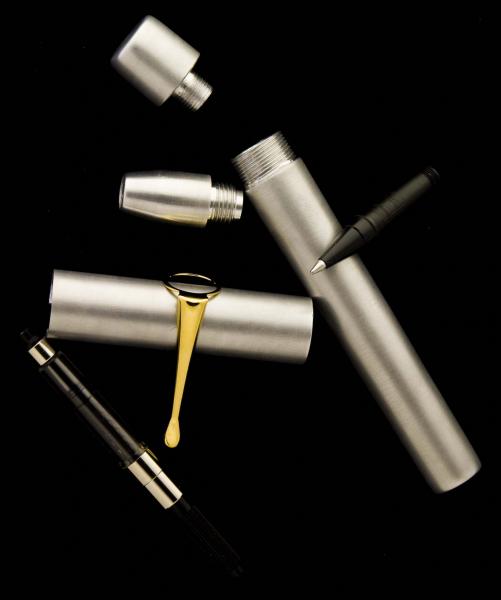

Doc, another masterpiece, using the Schmidt cartridge roller ball eliminates the spring and step drilling and gives the opportunity for color refills , great idea.

Roy, Thank you ! I really like the cartridge rollerball system...seems to bridge a gap in custom pen making.... for people who prefer rollerballs to fountain pens.
