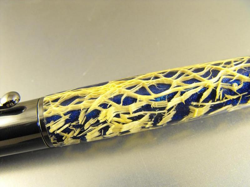

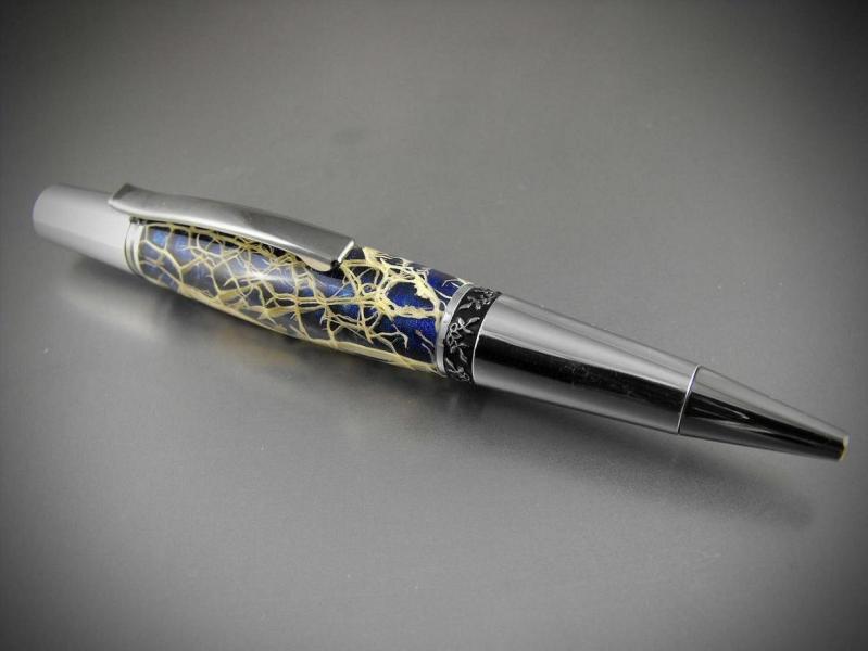

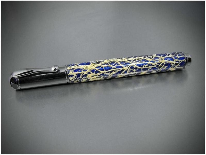

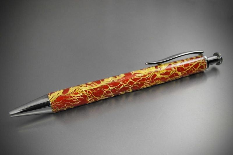

Got some cactus blanks from Curtis, and they are some of the best looking blanks I have ever come across. Almost did'nt want to cut them up. But I did :biggrin: :cool:
I used 1 Blank for the PITH and sent it to bitshird, and the other blank was used for a ZEN and an Aero for my wifes birthday. 3 pens out of 2 blanks:wink:. The ZEN and the Aero are the perfect size to use up 1 blank with no extra cutoff. The longclick left a small amount that I will need to find a use for.:rolleyes:
The depth to these banks are AWSOME and the color combos you can add are a real hit. I used some Red and Blue Automotive Touch up paint for reverse painting of the tubes. The alumilite turns easily and the final product was very well recieved.
Thanks Curtis, I know cactus is a real PIA to mess with. Coments and suggestions are appreciated.......

They all look great, but that Zen is AMAZING! Love that deep blue color. Is that color part of the blank, or just the automotive paint showing through an otherwise clear casting?

Thanks for the nice comments, :biggrin: The blanks are super easy to turn.
I used the "Standard" ca finish to seal the cactus and the touch up paint is the only color used on these clear blanks.

Having carried the red one and using it for the past few days, I gotta say it's a great pen, Lupe did a great job, I'll bet the others are just as sweet thanks Lupe.
