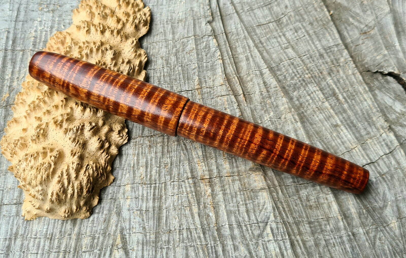

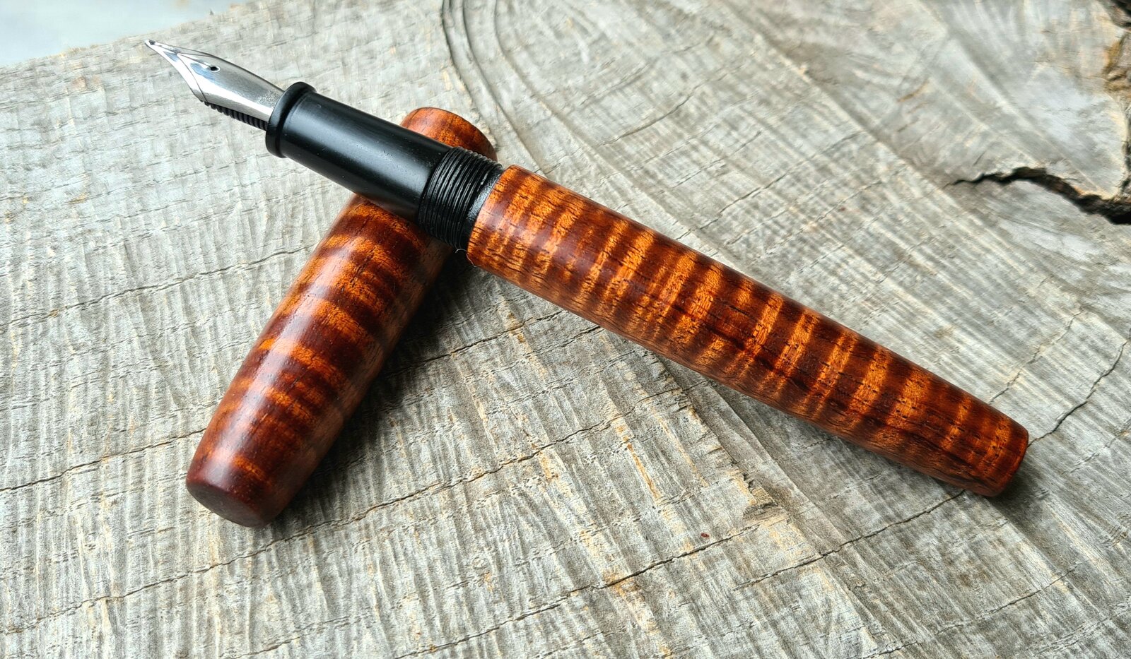

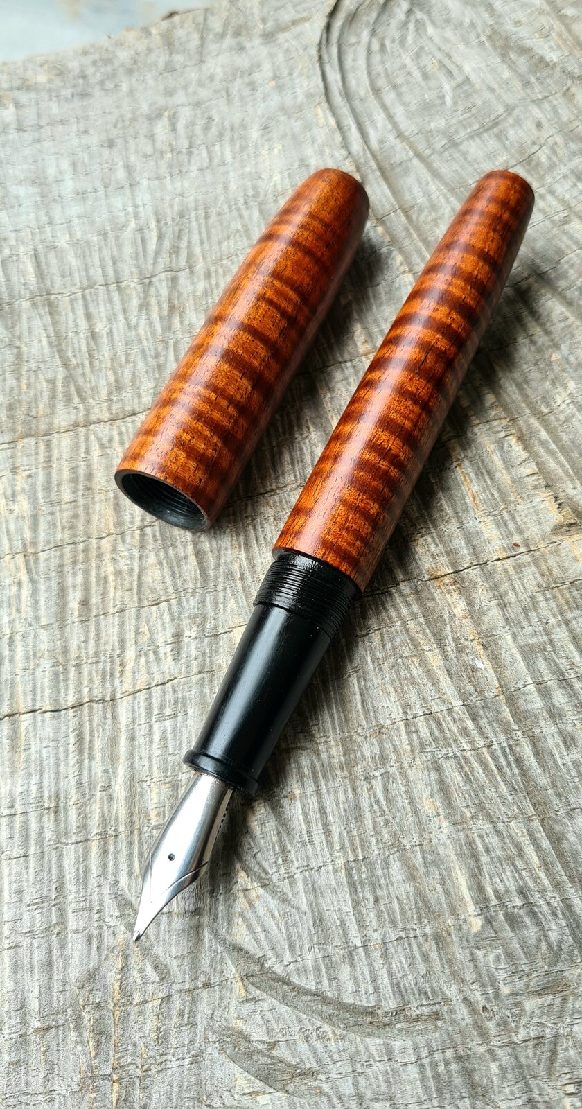

A beautiful piece of Spanish cedar with curls that rival koa and blackwood!
Ebonite lined, section also ebonite.
Jowo #6 nib
Thanks for looking.
Casey.

What diameter do you make your ebonite liners ?
CjG78
Feb 2, 2020
759
Australia
Thanks for showing ! !
Another masterpiece ! !
Thanks Mal, for the cap I drill 13mm and 15 mm holes and make an ebonite plug that slides in, then I drill 10.5 and 13 mm into the enonite and tap it.
For the barrel I drill 14mm, 10.1 mm and 9 mm in steps. Then I turn a piece of ebonite and slip it in, then do the internals into the barrel
