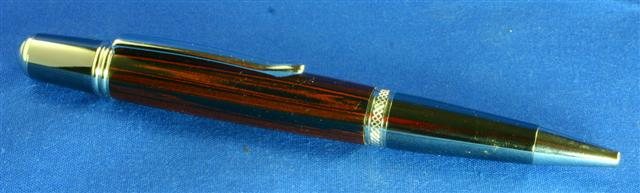

I found this piece of cumberland (ebonite) and it was just enough to make a sierra. I thought I had used all I had. Please excuse the dust. I wipped it off...really I did. I hate dust! :D
Comments welcome.

Another one of those cocobolites! I had never seen that before until that other one showed up a few days ago. Very nice work.

You know Don... I've made the very same pen with the very same material and about everybody that has seen it asked me what kind of wood that is....

This pen is sanded to 1000, then MM to 12000, buffed with white diamond and HUT UltraGloss Plastic Polish. Then I used a product that I started using a few months back(off and on) and now I use it on most all pens. Now I suppose you want to know what that product is. Well, OK. It is Flitz Metal Polish Fiberglass Paint and Plastic Restorer.
http://www.flitz.com/index.html I really like how well it performs. I've been using a cream scratch and swirl remover, but Flitz has taken its place.
I've put a CA finish on these pens before, but not on this one. I don't remember if the pen Glenn mentioned has a CA finish or not. I have a couple in my case that do not have a CA finish and they still look like they did when I made them.
Thanks again for looking and commenting.
