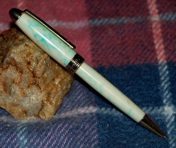

I was at work when I posted the message and I had not seen the pen in years, my wife has kept it for some reason at her work. So I had her bring it home so I could take a pic, sorry about the poor quality of pic. This pen came from my bathroom sink for Mempis Tn. It is one heavy pen.
