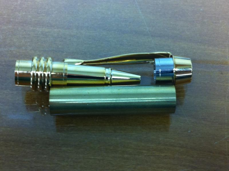

I am looking at using a CSUSA Executive Rollerball for a heavily modified project and I am wondering how sensitive the pen is to cap length.
I can't tell from the picture how long the rollerball nib section is.
Has anyone worked with one of these before?

Hopefully this helps
I snapped a quick picture of the cap assembly so you could see a little better how much play you have with the tube length. the cap/clip assembly is hollow so the tip could go up inside the cap/clip if necessary. If you trim the tube too much though the only issue you may run into is the end of the clip being longer than the cap assembly. May require some other modding to work for you application.

To answer this question, you can remove just over 1/4" and still use the clip or 1/2" and still have the cap clear the tip of the refill.
In that case, the clip overhangs the cap, but it can be removed if you are ambitious enough. This clip is REALLY well attached. It took me several minutes with a dremel to get it cut without nicking the cap, then almost 1/2 hour to get the pieces of the clip ring removed.
Overall, I am very happy with this kit. It goes together smoothly, the cap has a good feel to it, and it has clean lines. I can't speak for the balance of it because of the modifications that I did, but the rest is top notch.
