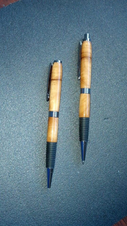

Tried a cross cut Walnut comfort set last week. The grains were interesting. Someday I'l do different kits but I'll learn as I go. I'm not in business to sell pens, just find this hoby theraputic......to a point. Any suggestions on what to do differently will be appreciated.

End grain is always very interesting to work with. Nice looking pens. I go along with Steve, and discard the rubber piece. By the time you have your pen assembled, it's picked up dust, discolored, and can't be cleaned. Not using it also gives you more blank to show off and balances out the preporshions of the pen better. Jim S

Nice looking pens, good fit and finish. I go along with the others in not using the rubber grip unless you have some body who wants it.

I like this hardware with and without the rubber front. I have made them both ways and like them both ways. Nice job on these it is hard to get that the right diameter where the rubber meets the wood. You did a great job mating the two.

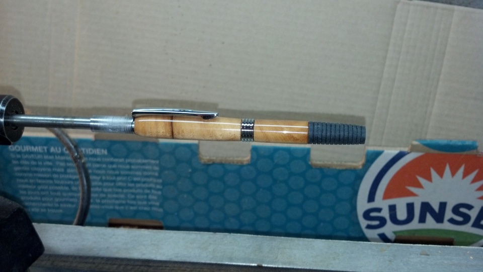

Actually turning this one was not that difficult and didn't feel like the wood was going to split apart. I have a shot of it on the lathe.

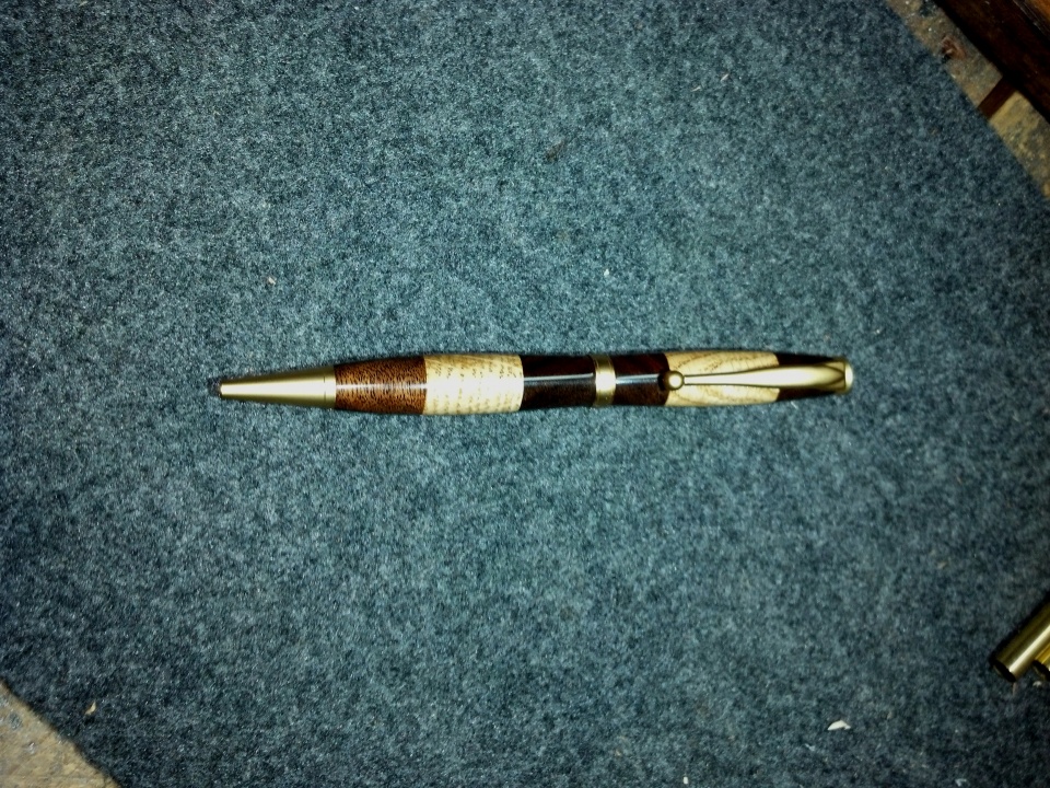

The other is of crosscut pieces I had left over from other turnings (walnut and oak ) as an experiment. That was interesting. Camera phone pixs are not very complimenteray but you get the idea.
