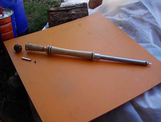

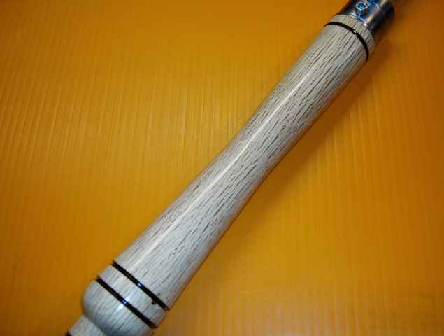

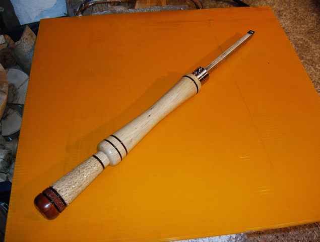

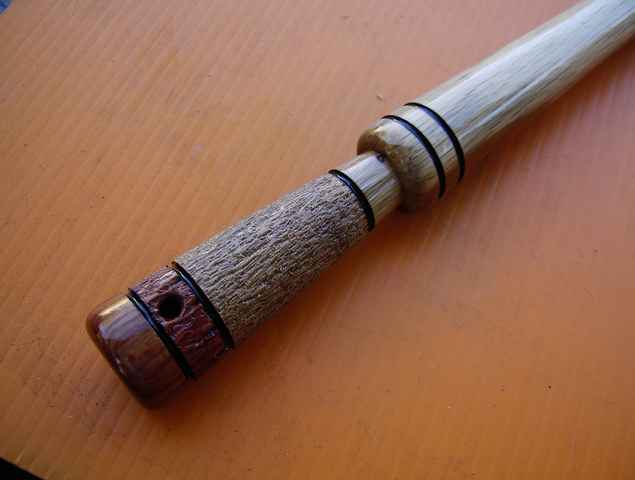

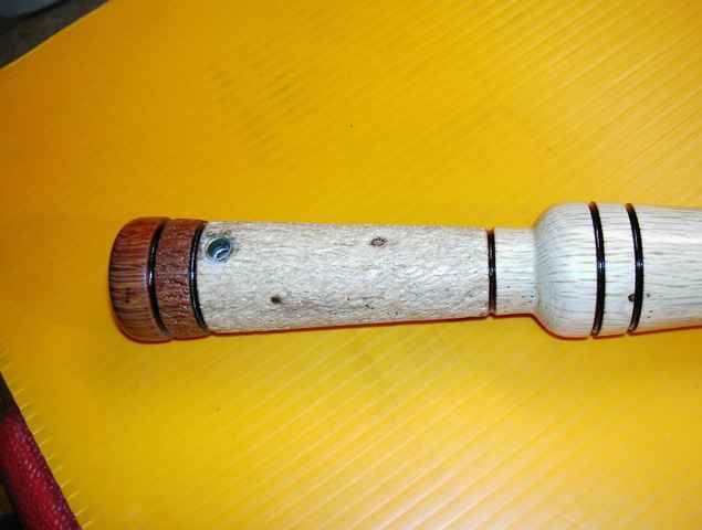

Charles,
Well, I like to have nice looking tool handles, particularly if I'm the one to make them, I use this design and finish (pics attached). I like the "texturing" grip these handles provide, it certainly gives you a firm grip even when your and is a little sweaty ...!
A good (strong) ring and some epoxy to glue the tool to the handle and even snakewood will last...!:wink::biggrin:
Cheers
George
