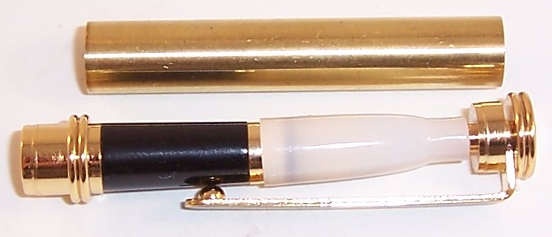

If there is a trick to the assembly of this kit it would be seating and adjusting the inner cap especially if it is the first time one tries it so I came up with an easier solution. Looking at the photo below you can see that by threading the plastic cap onto it's post before glueing and turning the blank then sitting the tube next to it, you can easily see how far to thread the cap on. This is an easy way of setting the cap just right so when the blank is turned and notched, it can be pressed together for a nice snug fit.

Below you can see how I nistall the inner cap before glueing and turning the tubes.
