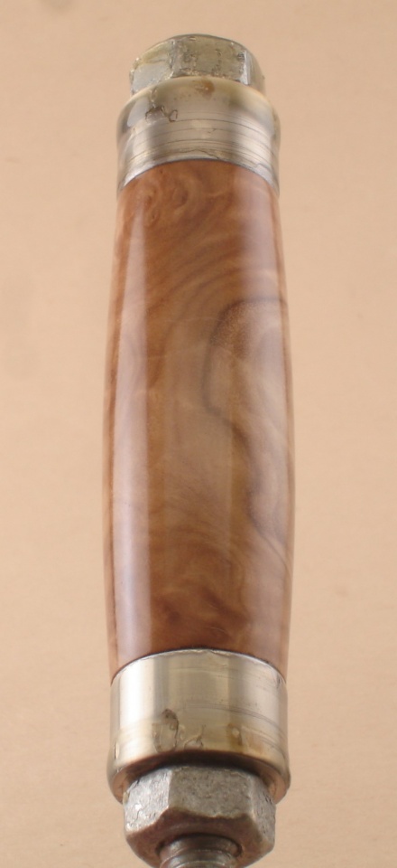

Didn't want to hijack a thread, so I decided to post my results using Craft Coat as a dipping finish. I have been using a different product with good results, but wanted to try something different. I will update this thread and post photos at each stage of finishing. The first photo is of a couple of mallee burl blanks. I start sanding at 400 grit and use the Enduro sanding sealer from General Finishes to create a slurry to seal the blank and fill in any imperfections or open grain. Switch to 600 grit and repeat. I move on to Abralon pads starting with 1000, then 2000 and finally 4000. This leaves the blank nice and smooth. Check out the photo, this is what the blank looks like after this step.

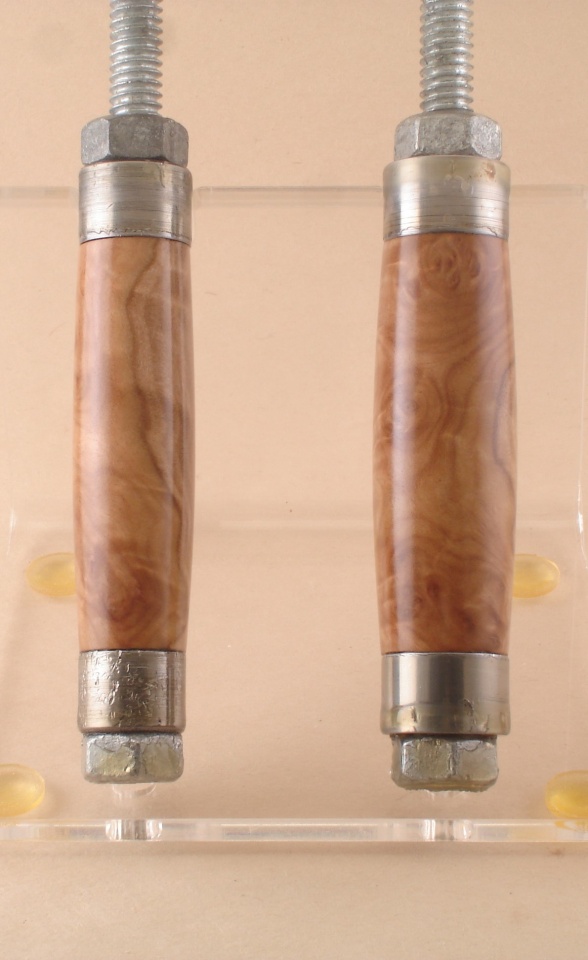

Next step is to set the lathe as slow as it will go, and apply 6 coats of sanding sealer, waiting at least a minute or two between coats. Set the blanks aside and let cure overnight. Set lathe speed to 1250 and starting with 3200 MM polish blanks just enough to even out the ridges. Move on to 3600 and finally 4000 MM. After that process the blanks look like this,

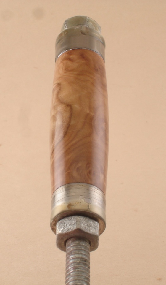

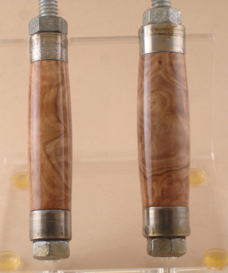

Here are the blanks after their first dip. I'll let them dry overnight and reverse them before dip number two.

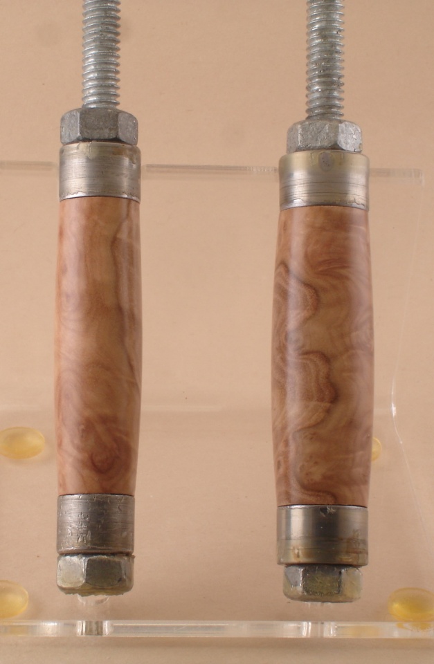

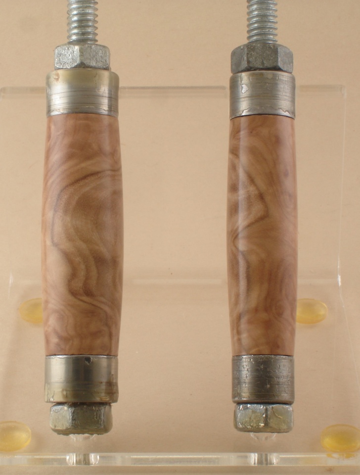

Here are the blanks after the second dip. They seem to be starting to show some depth.
