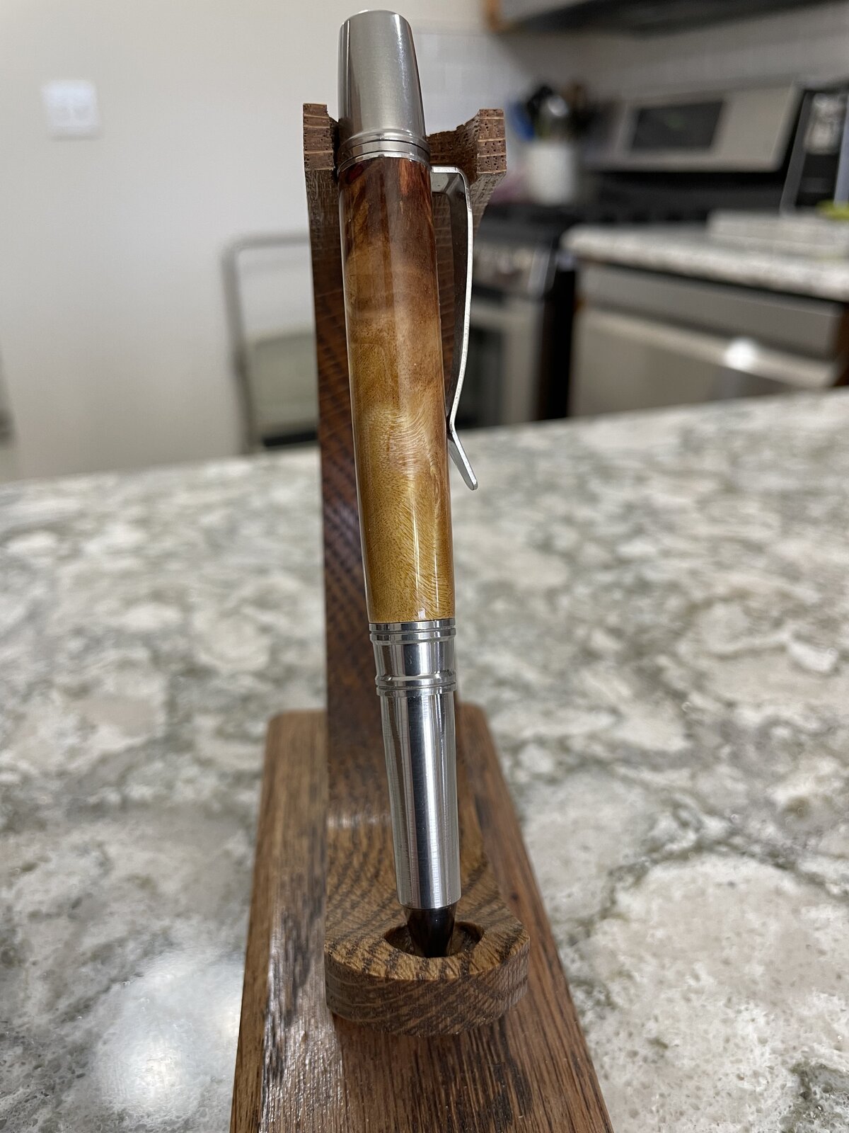

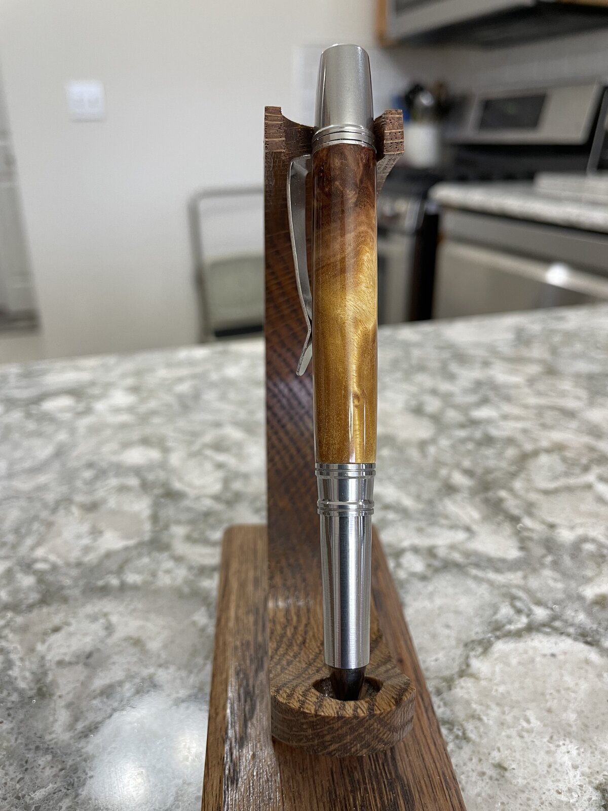

This is my first one of these. I must have really screwed this up somehow. It's not a difficult assembly. Any ideas on what I did wrong because honestly I'm at a loss?

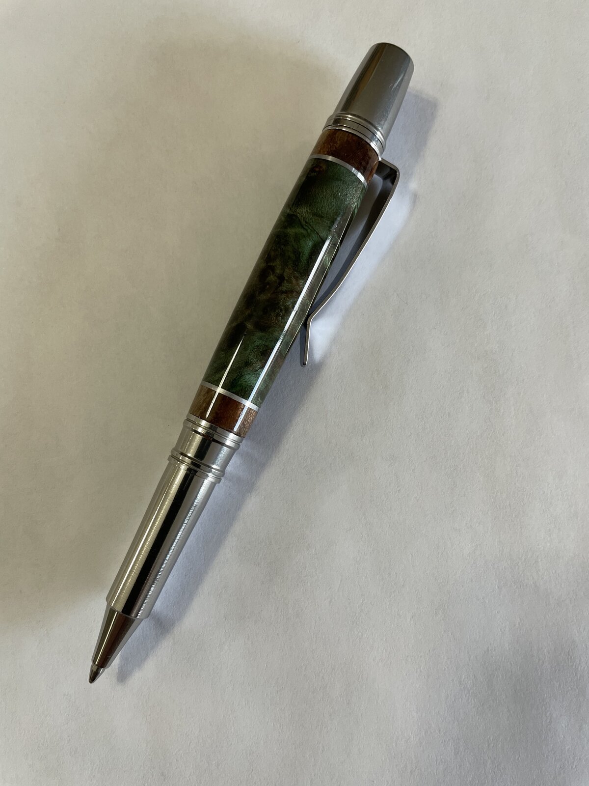

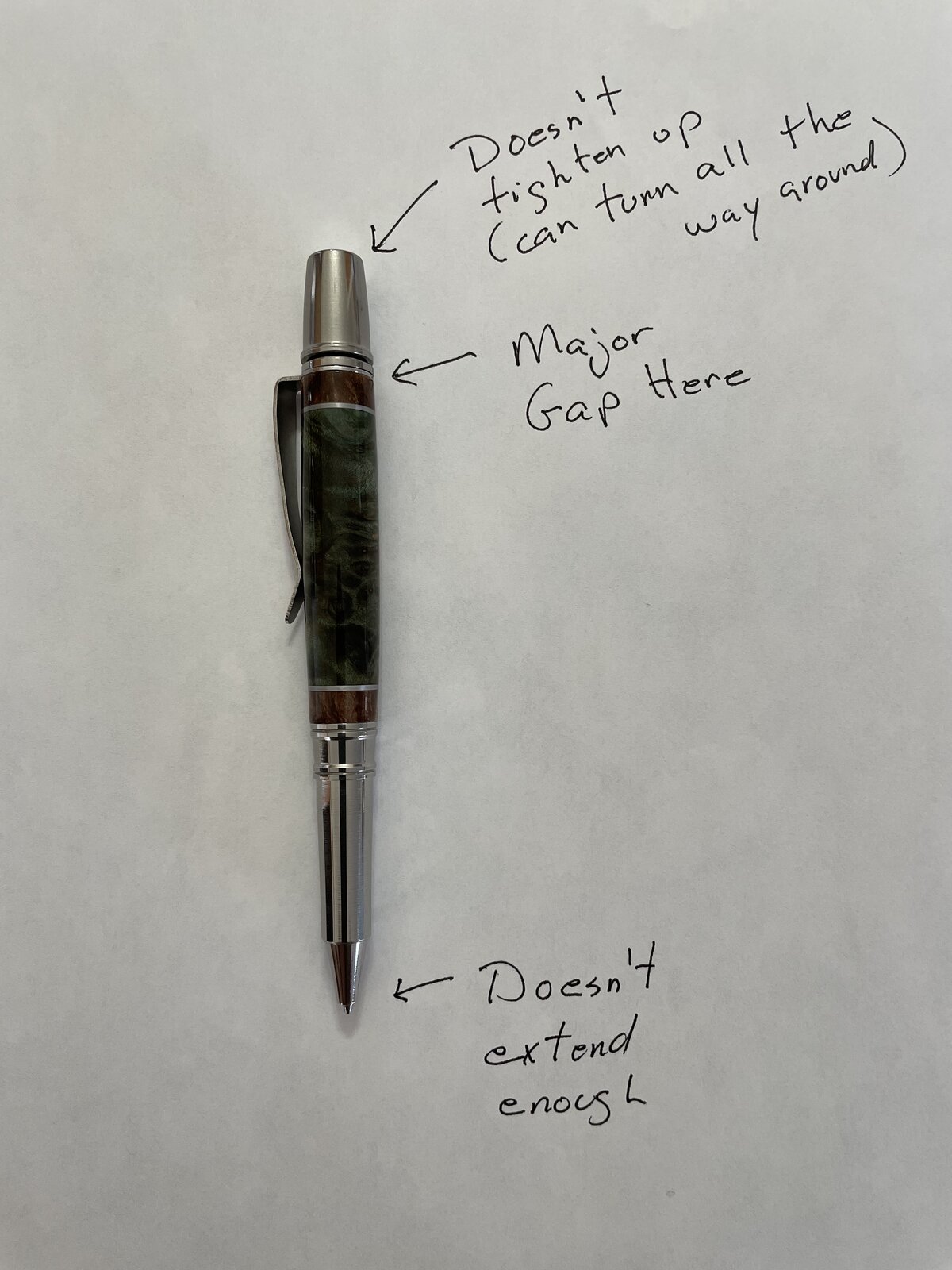

Well I'm the type that can't sleep when something with my name on it has issues... So I'm down in the shop going through parts and it appears there's a few of the threaded press in parts where the transmissions hang up a bit on the internal threads. I can force the issue gently using vice grips to turn it but obviously that is not ideal. I'm going to put together some photos in the morning and email all my customers so they know what to look for so we can try and get replacement parts to everyone before they turn pens. Then I'll be having a chat with a machinist about why our threads aren't as consistent as they should be....

I'll get a post going later with how to check and what it looks like when it doesn't go far enough. Constant is looking into how the threads are made and we're going to test every single part we have here. Manufacturing... It's fun.

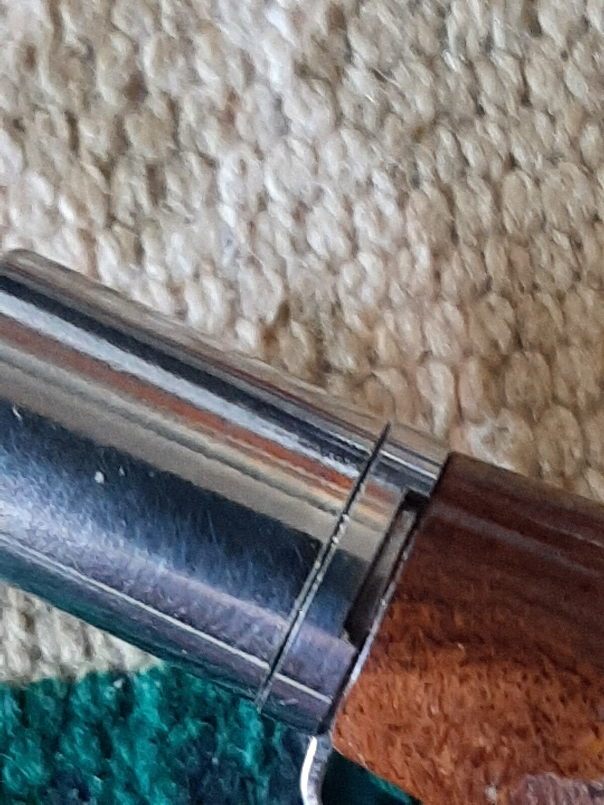

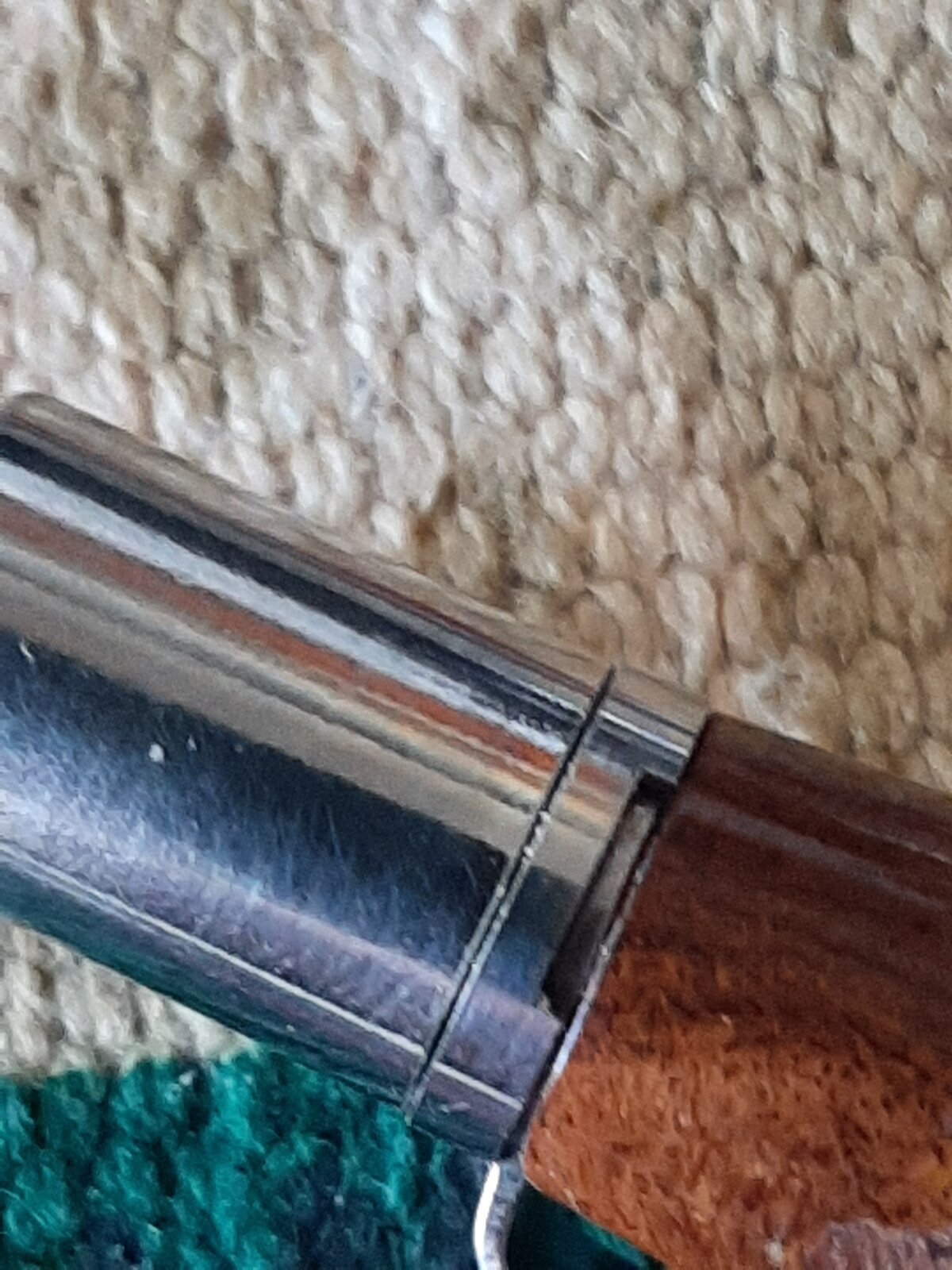

The Coyote I made several years ago has a notch the clip must seat into. I failed to do this and ended up with problems like the original poster.

We actually did away with the notch as part of the plan to simplify the kits. Next feature will be... The transmissions actually threading all the way in! Already working on that and testing pieces so we can replace any that have issues. I've ruled out our finishing process so we're sending some defects to Constant to have him look at and we'll adjust the manufacturing process to get back to that 1% or less failure rate I was aiming for.
