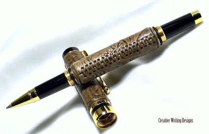

I am with Jon on the leather. When I designed my leather pens (polymer) I was inspired by the tooling on the sadle. Pick up an issue of "Cowboys and Indians" Magazine and something will catch your eye.
Turquoise accents would be nice too!
