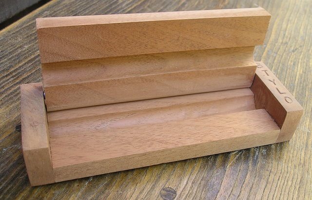

wood-of-1kind
Jul 10, 2005
4,115
Toronto, ON, Canada

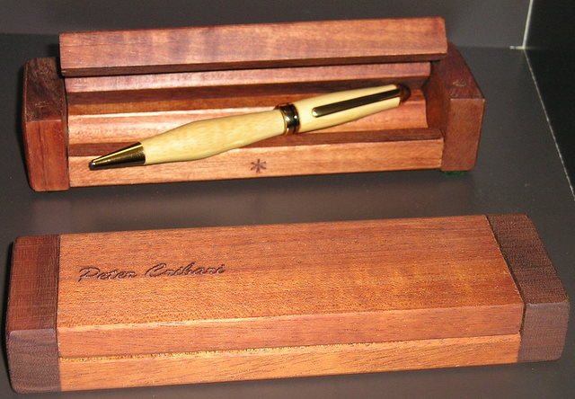

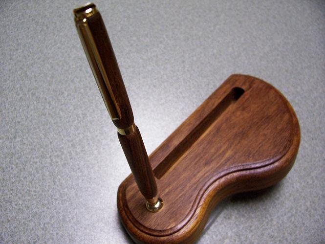

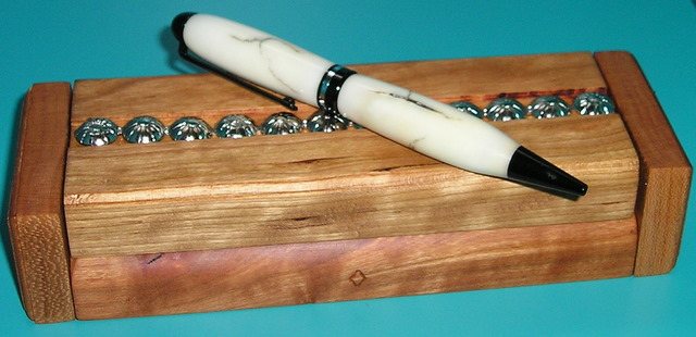

Originally posted by NewfGuy
2) They also want me to make a box for it. Can you post pics of the boxes that you've made?
Hope that a few of these inspire you with some ideas.
-Peter-:)

wood-of-1kind- What do you use for hinges on your single pen boxes? Are they just some kind of dowels, or are they hinges? Thanks, Nick
wood-of-1kind
Jul 10, 2005
4,115
Toronto, ON, Canada
Nick, I use "pop rivets" as hinges. Real inexpensive and you can trim the pin to any desired length.
-Peter-:)
