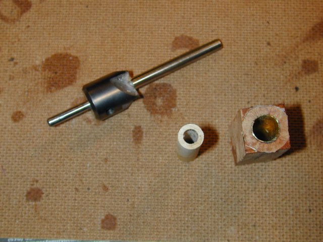

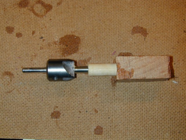

Follow Rons sample...turn yourself some "shims". Saves a lot of time actually by not having to change the center guide [:D]

Brian, if you have a 7mm barrel trimmer you can slip a 7mm tube over it and it fits nicely into an 8mm tube.....thats all I ever use to trim Perfume Pens!!

I use what ever I have hanging around. I've used maple, corian and I've even used a rejected slimline pen barrel with a tube all ready glued in.
