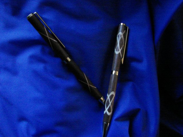

Unless I misread your question (which is possible) I think you're misunderstanding the saw kerf problem. It really makes no difference what width kerf you use (other than wasting a small amount of wood), it has more to do with the thickness of the inlay. I normally use my band saw, just because it's handier, since I don't have a decent sled for pen making. I then sand the cuts smooth with my disk sander. I normally use scrap pieces of veneer I save from flatwork to use in pens. Here is a pic of a celtic knot pen using veneer as the inlay. It's not what you take away that as important as what you put back! Does that make sense?

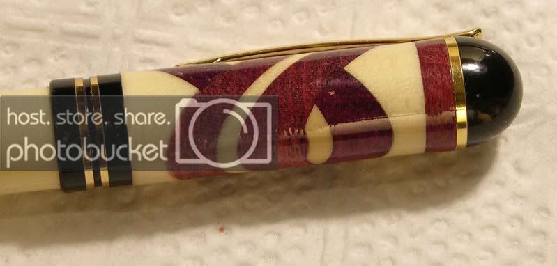

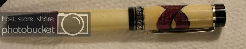

The point of your kerf matching the thickness of your wood inlay is to keep the outer edges of your blank in line and the edges of the interlocking pieces of the circles matching up. You can make sure the pieces of the circles match up by just looking at them carefully when you do your glue up. You may end up with the top part of your blank a little out of line with the bottom part but you're going to turn away the outside of it anyway so who cares?
Just to reiterate, you can do circles that are WAY thicker than the kerf of your blade. The miterbox saw kerf is less than 1/16th of an inch and these circles far exceed that! In the top one I sanwiched maple between purpleheart and used that as the circles in holly and in the other one I think it's just a single slab of purpleheart in holly. I don't have a planer so I take 'em at the width they are when I get them from the cut-off box at Woodcraft.
