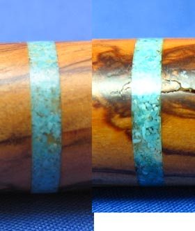

OK...this is the only picuture I could find and it was the first time I used the imbossing powder. The wood is olive wood and is cracked..I carry this pen daily and it has had some abuse. I have have bad luck with olive wood cracking, but that is another post. This ring could have used a little more powder, but as I said this is my first try using this stuff. I will try to find a later picture that shows a better job on my part. This was actually my pen # 16.

Nice job! Up close, in the right-hand picture, you can see some of the voide, but overall it looks great! Very uniform thickness. I bet a black band wouldn't even show the voids. I picked up some black and another color (I think light blue) when I was at the craft store. I didn't see the torquoise! What did you think of working with the powder? Were the particles too big/small? What technique did you use to affix it into the ring? Did you use a friction polish? If so, did the heat make the crystals in the powder expand?

The embossing powder is a fine powder...little plastic pellets and is used much like stone dust. I cut the groove and place in the powder and add a drop of thin CA. Just like the instructions by knottyharry in this thread. The void in the right picture happened sometime after I made the pen. It is not where some powder let go. This particular pen had cracks all over...I love olive wood but it is prone to cracking...at least for me. Hobby Lobby here has atleast 20 colors or more. The turquoise I used is really close to the real thing.
