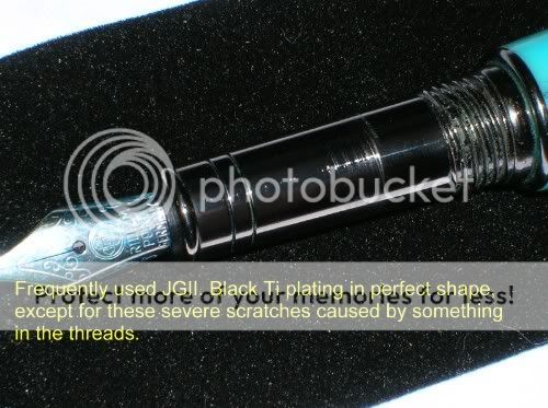

Could this be what's damaging the cap threads?
redfishsc
Feb 11, 2006
2,545
North Charleston , SC
I was sitting in class yesterday studying Greek participles. Exciting stuff, right?
I went to take the cap off the Jr. Gent II FP and did what I always do--- I "whirled" the cap off. Not "twist" but "spun" or "freewheeled" it--- ie, spinning the cap with enough force to unscrew it and then have it revolve a time or two after the threads have separated.
The it hit me, it's rotating on the nib EXACTLY where the spiral scratches are.
It looks to me like the Delrin threads are the actual thing cutting into the plating, but I can't imagine Delrin actually doing that to black-ti plating that otherwise looks PRISTINE even after a hard year's labor.
But repetitive spins....kinda like a stone at the bottom of the creek, give the water and silt enough time and it will polish it clean.
For those of you having the spiral abrasions on your pens, are you twirling the cap as you take it off?

I dont "twirl" the cap off the end of the pen but I have been looking for the Culprit of the plating "scratches".

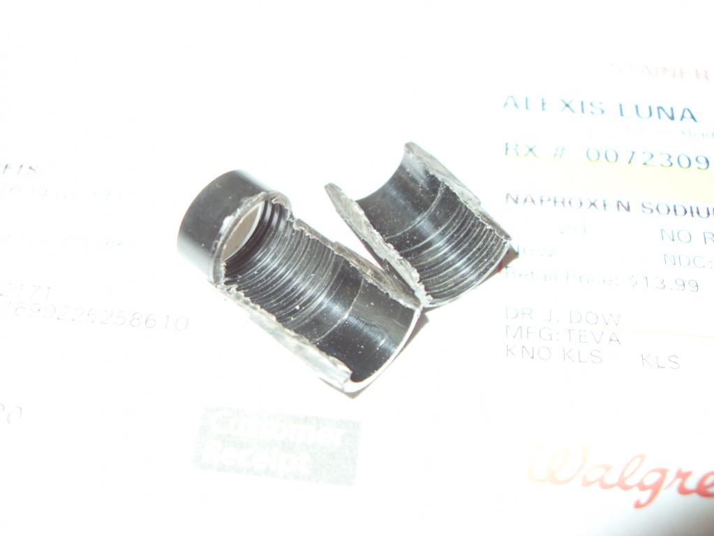

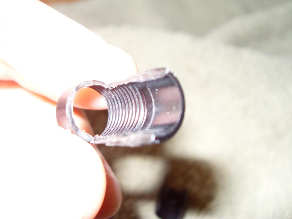

I have seen a problem with the Black "Plastic" thread insert on a Jr gent II. I took a NEW black thread insert to work and cut about 3/4 of it in half leaving enough of the insert to cap my pen.
There is a "ring" inside the "thread insert" above the threads that looks really rough and chewed up when inspected under a light microscope. I am not sure how the thread insert is made(Injection molding maybe???) but it appears that the "rough ring" is rubbing on the plating as the threads are engaged. The pen is twisted into the cap and the "threaded gouges" on my Black Ti plating lines up with the ring on the cap. The engaged threads raise the pens nib causing the wear seen on my pen(spiral scratch around the niband the end). I cant take light microscope pics and tried to get some SEM pics but the part is too large and my SEM's magnification does not go that low....
So it appears on my Jr Gent II that the scratches are coming from the "rough, chewed up ring" above the threaded cap insert. I will try to clean up the rough egde using a dremmel from the other end as to not damage my threads when I get a chance.....If anybody else sees the same ugly ring let us know. Its kinda hard to believe that the plastic insert would cause such a deep goug on the plating. ....

I've noticed that ring inside it before, but it's so far up in there it's hard to see it. I may see if I have a sacrificial thread part (ie, a goofed up kit) that I can cut in half on the bandsaw for closer inspection.

Last week I decided that this was the culprit in my case. I took the cap apart and cut off about half inch. The very top part protrudes slightly yet it is enough to contact the narrowed pen part just below the nib. All I did then was to roll up some sand paper and sand the inner and outer edge.
Of course, since the pen is already marked I don't know if this is the fix but I will try it on the pens I make from here in.

I dunno, Ruth. If the scratches have actually scraped the surface of the plating, any attempt to buff them out might remove more plating than you'd be happy with.
If the scratches are actually just plastic residue that's marred the nib, I'd assume acetone would remove it (acetone won't hurt the plating but will wreak havoc on your blank finish).
What is on my JGII nib coupler is way to deep to be buffed out, unfortunately. Then again I've used the heck out of this pen so I can't complain too awful loudly.

Here are really overexposed pic's that I took. Wish I had a better camera.....

Matt, I haven't had it happen to either of the Jr Gents or any of the Barons I've done, but I got it on a Ti. American 2000, I managed to buff the scratches off the front section with a flex shaft with Diamond paste on a hard felt buff, took the cap apart and chamfered the tube and the thread connector with a counter sink, no problems since then, that might work on the connector for the Gents as well. only do it in both ends, don't try to cut into it, just lightly break the edges of the first thread and the opposite end, chamfering the tube also makes things go together easier
