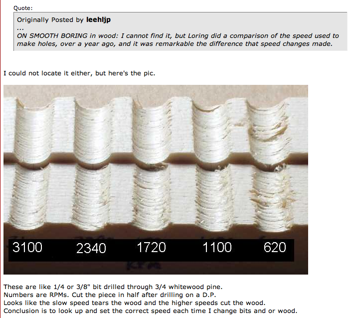

As Curtis said, it will come down to differing opinions. I have a pict below of the speeds in soft pine. It is easy to see that the faster speed produces smoother cuts, and there is a reason for that - "speed" cuts; "slow" catches. Slow works fine only in proportion to the sharpness, tolerance of the drill, and firmness of the grip on the wood or other material.
There are optimal speeds for different woods and materials for the kind of bit that is used. Also, as mentioned above, heat is an enemy to some, and the answer is not necessarily slower speed - but smaller bites and frequency of bites.
