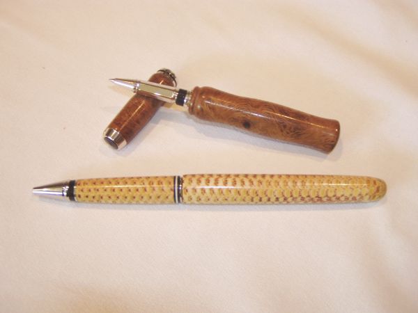

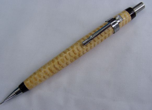

I got my corn cobs from the States:biggrin: they are not stabelised Don ward get them for me from a pet store I think ( to feed the squirel ) I use lots of CA to stabelised them and have no problem
Did this cigar 4 years ago
Made this one last year

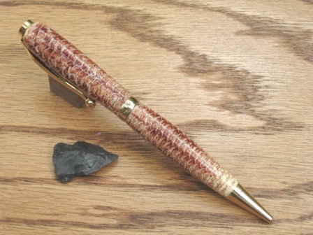

I`ve turned a number of the corn cob pens and none have been stablized.
My method is very simple. I cut cob longer than needed then drill,after drilled I then soak with thin CA inside and out, next I redrill and cut to size,
the next step is to glue in the tube and square the ends,next I turn, reapplying CA as needed. This is the results. btw I never dye them,I like the natural color.
