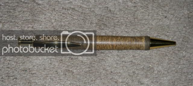

I too build custom fly rods and also have a lot of cork at my disposal. However, I prefer turning my Cork Pens out Burl cork rather than the specie variety. Below is a photo of a CSUSA Gold Clicker Pen turned from Burl Cork.

Thanks for the kind words about the Pen. That's a very poor photo, the Pen looks a lot nicer in real life.
Yep, the end pieces are "rubberized" cork. I use the same set-up on my rod grips (end pieces are rubberized" cork), as that's where the most damage occurs to a grip. I've also turned quite a few Sierra's out of Burl Cork. IMO, they look good and wear well.

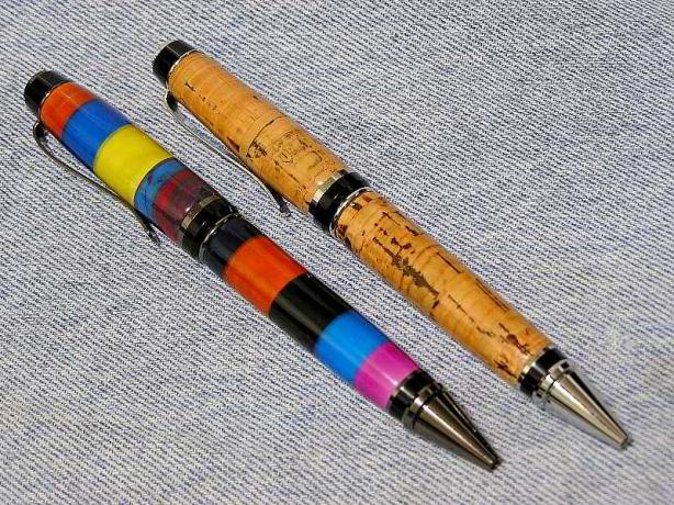

I've made several I used to make fishing rods and have a bunch of old busted rods. I take the cork from old rods and recuse the them. It's not easy cork is tricky to work with. I use a very sharp skew with a scraping action on the highest speed possible. Then sand to final size. I've used a CA finish and a natural cork sealer like a fishing rod.
Here's a photo of one I made it has a CA finish next to a bowing ball pen.
