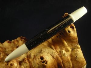

Here's a pen made from Black and White Corian
Skye
Jan 3, 2006
3,487
Rock Hill, SC
^ Do not be swayed by this man into making corain pens. His freakish ability to make nice ones cannot be duplicated.

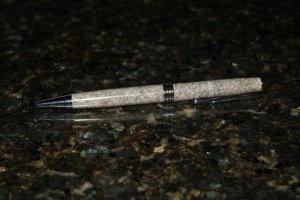

I picked up some Corian from Jazzncar (1/2") awhile ago and finally got around to doing my first pen with it..
My experience: [it's about to cost me more money]
Drilling was a slow processes and with 1/2" you better be on center because there not really a lot of room to work with. I had a little blow out but nothing major, long as you have some extra length to square off on should be good.
Turning it was time consuming for me. I knew the material was hard so instead of going right to lathe I rounded off the hard corners on my belt sander. This, I think, saved me a considerable amount of time. (I do this with acrylics as well) However, I'm not pen turning expert like a lot of guys on this forum so maybe my tools just are not super sharp slowing me down. I could only get the corian to really chip off no matter what tool I used. A round nose scraper ended up working the best for me.
I turned the pen on a mandrel (brand new rod) and still came out of round. I've had it with these damn pen mandrels, no matter what I do I always seem to be out of round and it's not like I'm 'pushing' into the material. So JohnnyCnc is going to get an order from me soon for some TBC equipment.
For finishing I hand sanded to try and work out some of the 'out of round' and then started with the PSI acrylic sanding pads. I wet sanded through those and then applied novus 2. I have to admit I heard a lot of people rave about this novus but I've tried it on acrylic + this corian and I'm not very impressed. Luckily I picked up a sample kit off amazon which had all the novus polish for like 5 bucks. (maybe I need to sand more before applying)
In the end turning the corian has made me decide to buy a few more toys :
Turn between center setup - From JohnnyCnC
Some carbide tipped bits - Where ever I find them the cheapest lol
My first carbide tool insert set - getting from http://eddiecastelin.com/products_and_services -- like this guys youtube videos as well.
Anyway here is a pic : I know the picture is horrible but I had thrown out my back and was not in the mood to fiddle with the light box. Just wanted to snap one off and lay down.
