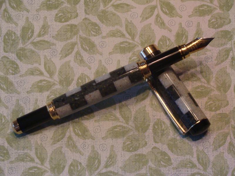

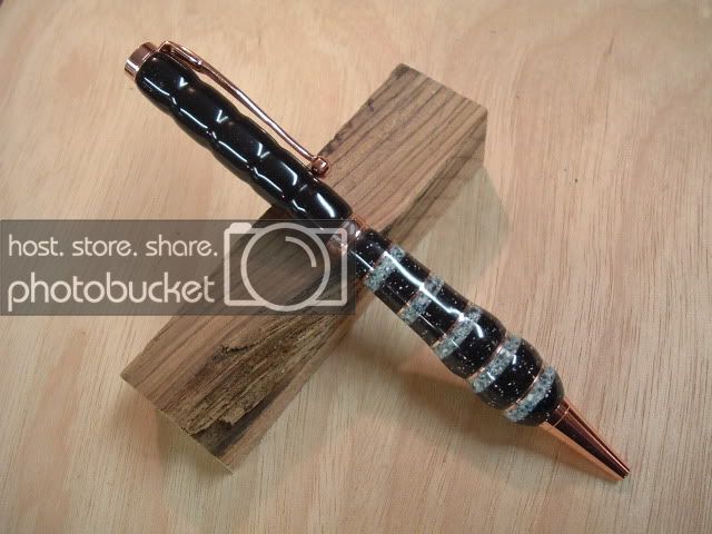

Try segmenting the Corian. It works just like wood and CA glue works great.

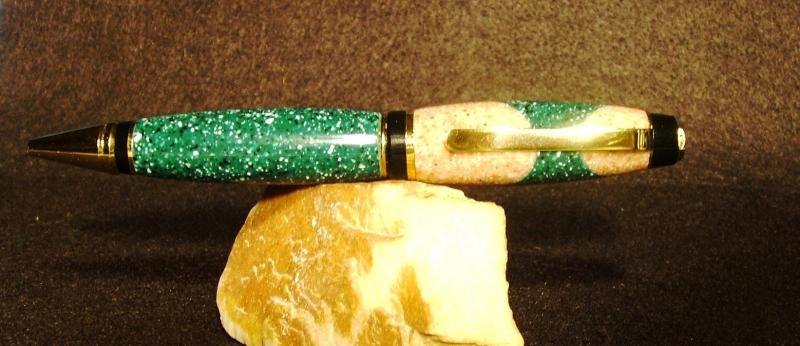

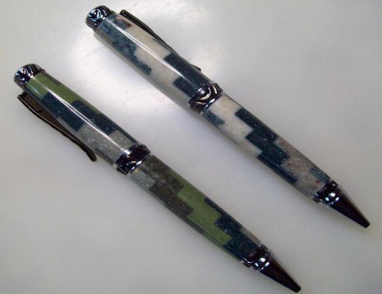

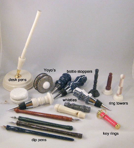

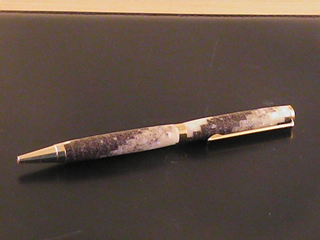

Hey Roger,
As with wood, you can do anything you want with corian, here are a few pics to give you some ideas. Don't say that you don't have the talent until you prove that you don't have it.
With pen making, if you can imagine it, you can do it.
The one with the copper are little squares of corian with pieces of copper roof flashing in between.
Make sure you scratch up the copper and corian with some 100 grit sand paper to give the glue something to hold onto. You can also use a soda can or other pieces of thin metal, all can be made using your regular turning tools. Give it a try, you just might surprise yourself.
Good luck
Tom, oops99

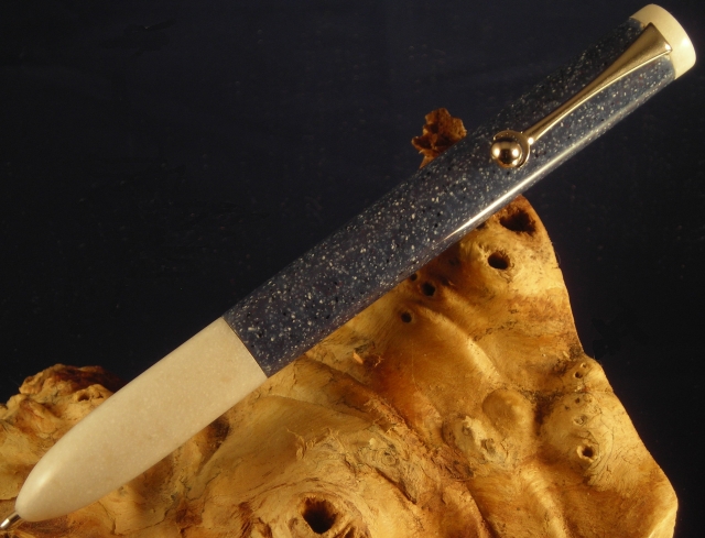

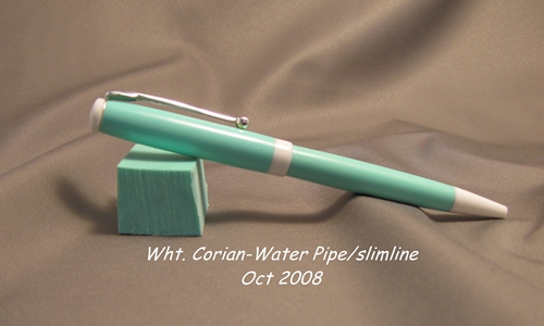

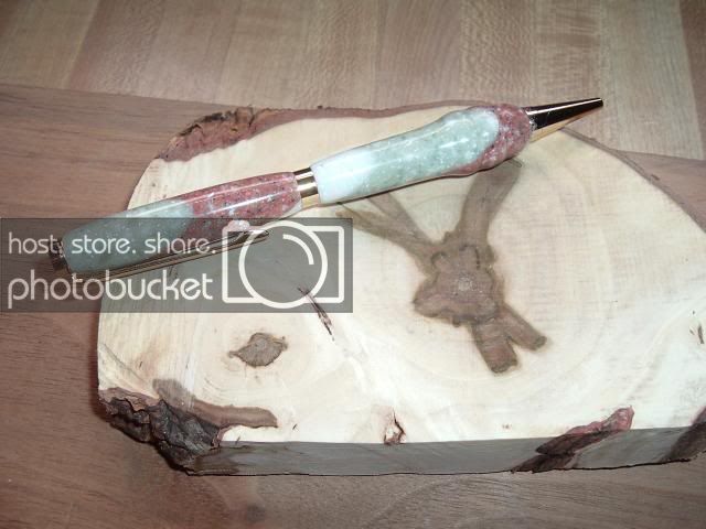

To add to the uses of corian related to pens, I use it to make nibs, center bands and finial on pens that have blanks made of different material. Example the finial, nib and center band on this pen is out of corian:

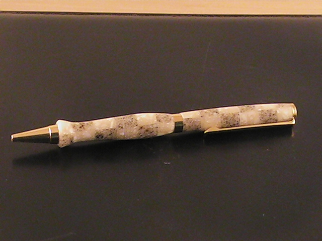

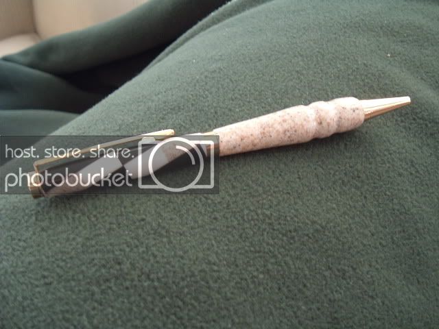

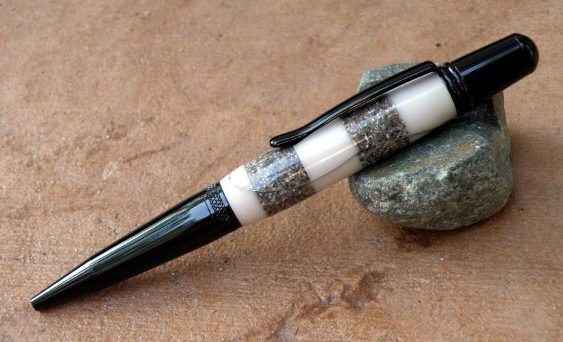

Here's what I've done so far with corian. But as you've seen from others, quite versatile stuff and turns like a breeze.

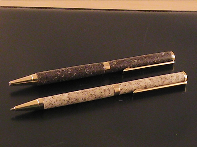

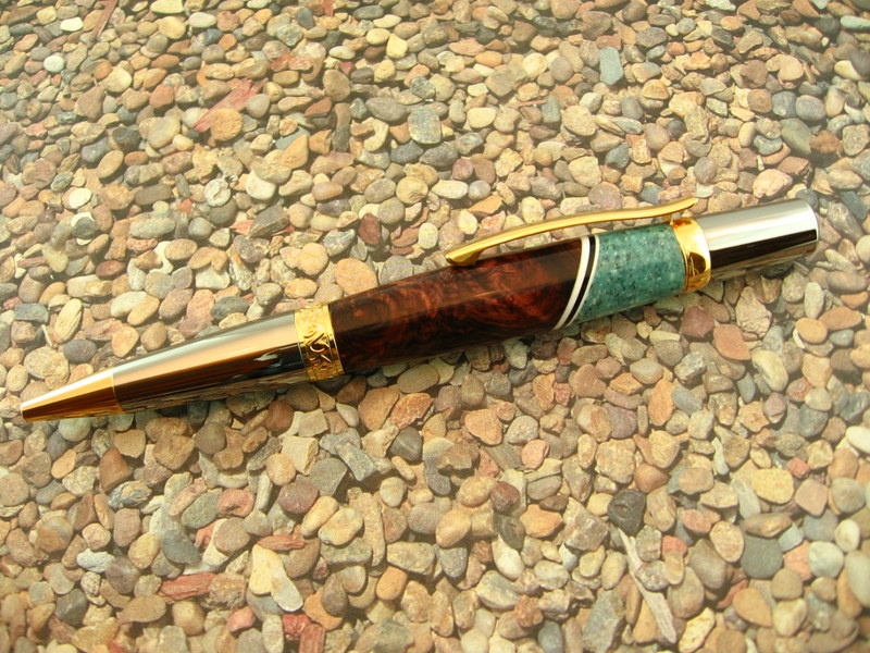

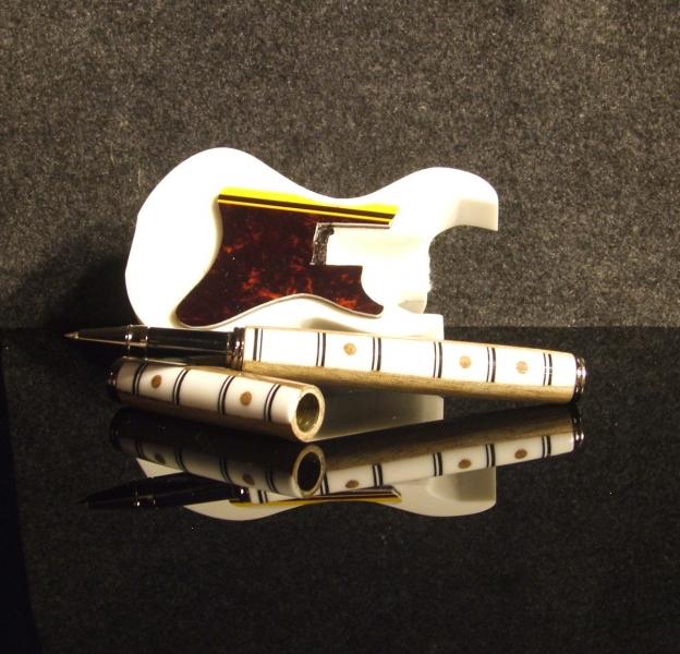

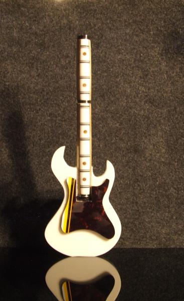

Here is a couple I've made with corian. :biggrin:
Aug 13, 2010
150
Cameron Park, CA
Max, way cool guitar pen! Great idea!
