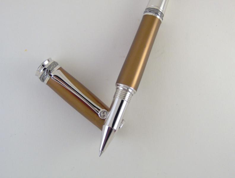

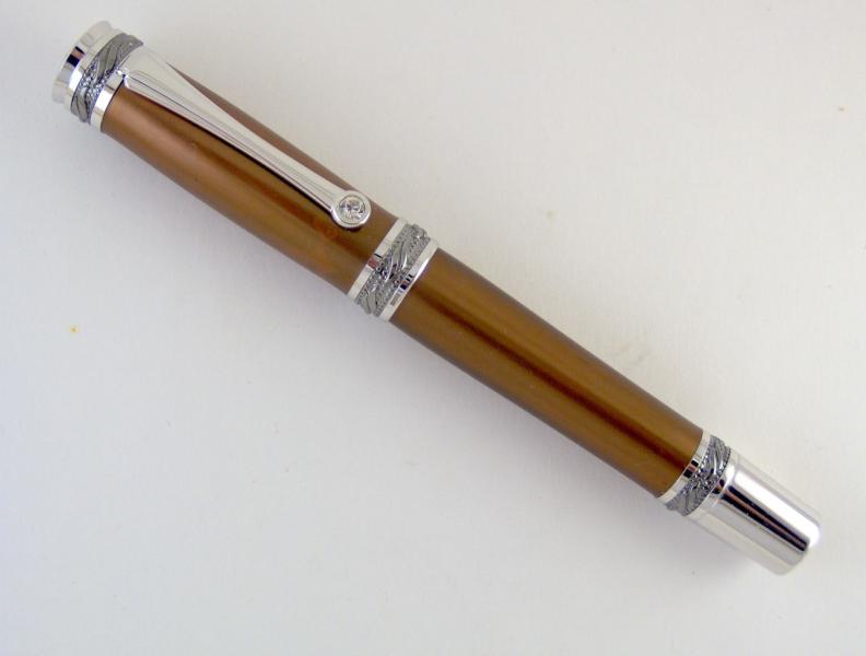

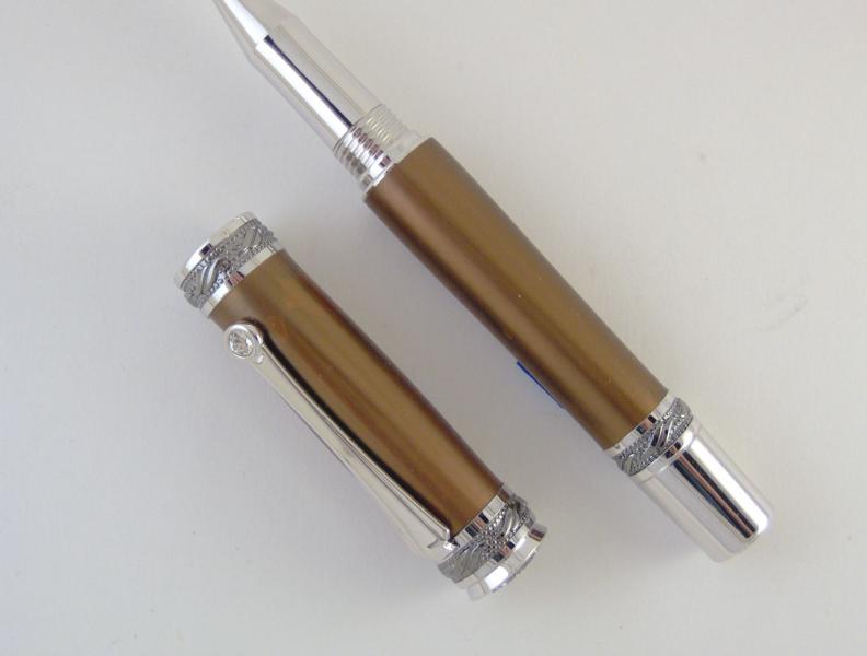

Copper color Acrylic of some type, not sure where i got the blank, i think exotics. It was not a walk in the park turning this material, tricky. Majestic RB. I colored the epoxy with pearl EX inside the blank and of course the tubes. Anybody remember the name of this blank ? Carl

Nice! I believe that is the metallic bronze from Exotics.
http://www.exoticblanks.com/index.p...category_id=4&option=com_virtuemart&Itemid=60
I beat Ed to it!:biggrin:
I CAN'T IMPROVE on THAT answer!!!
He's Right!!!
The material is a manufactured resin, similar to PR. It CAN chip as you turn.
As I advise on all resins, turn the ends down close to the bushings early, the chances of success are improved. I will "blow up" about one in 20 with this material--when I stop paying attention.

That it, thanks Everyone. Yep Ed, that what i found out. You look at it funny and it chips out on you. I found that out early on when i did the cap part. The barrel went much better. Carl
