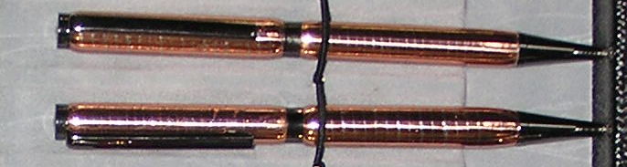

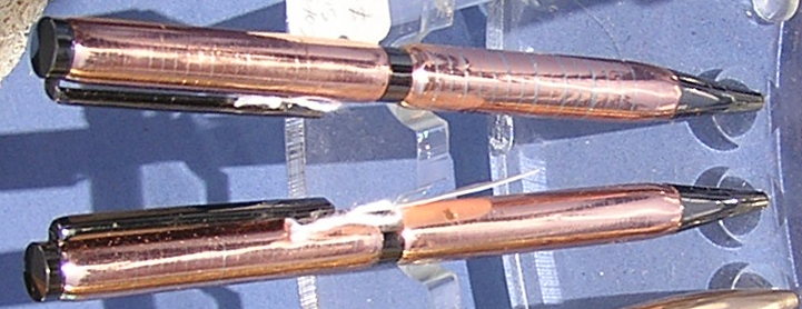

Below is a photo of a couple I did a wile ago. Sorry the only photos I can find I took a bunch when I made them but that was a different computer that has since passed on.
I am not going to read the article again but I did mine based on it. Now you say slipping. I think maybe you mite mean in the beginning. Anyway I used longer tubes than I needed, used a hose clamp to anchor the wire to my home made corian bushing. Then wile have the lathe turn very, very slowly wrapped the wire around the tube and anchored on the other end with another hose clamp. Now you did clean your tube and scuff it oh and used some flux. Now get out your torch heat it up and fill it with solder I did use silver solder. Soldering can be a tricky business it takes practice to get it to work for you. I used a piece of sheet metal under the blank to protect my lathe and ways from flame, melting flux & dripping molten solder.
Now that your past that let it cool get it off the lathe cut and grind the ends to get it close to size, length. Now the wire catching on you I suspect you do not have a good solid solder like I said it is very tricky I found it difficult to get the solder to flow. I have a metal lathe and had it spinning very slowly, just creeping, applied the heat and solder wile it turned and let it turned till it cooled. Otherwise I found the solder to just flow down and not fill the wire.

John, your copper pens are gorgeous!
Bruce, sounds like you've been there, done that! It's something I found interesting and thought I'd give it a try. I'll work on it some more this next week and let you know the results.
