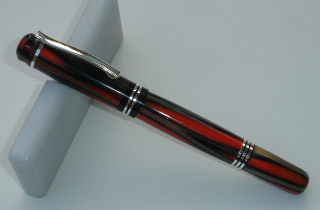

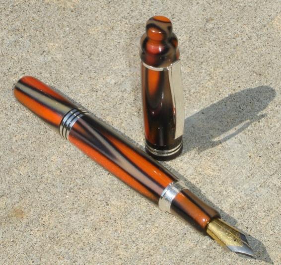

This is from a blank Ed/Dawn gifted to me. I can't recall what the name ended up being from the contest, but it sure is a cool blank. With some tips from Amos I was able to re-fit the grip section. I also wanted a closed end effect, but to keep the banding that came with the churhill kit, so I turned the final seperate and tapped it <uses same tap as a cigar final>, so if the clip ever broke it can be easily replaced. I ground down the final on the pen section and capped it over as well so that it can also still be removed. I like it, it looks pretty sharp to me.

Jeff, liking this blank and you did a neat job of disguising the churchill. Not sure I like the little nipply thing on the finial. But, guess that's why there is chocolate and vanilla ice cream.:)

The grip is awesome. The look is great. But to be honest, I am not feeling the bump on the finial. Not real sure why, it just looks out of place to me. All in all, a great pen though. What tap does the finial use if you don't mind me asking.

I'm going of memory Hans..I think it's 7.5x.5 I know the 7mm drill bit makes a perfect hole for the tap. I thought the bead on top of the final gave it some character..but maybe I'm wrong. If a customer wants it but just wants the top round, it's not problem since it just unscrews I can grind that off and re-polish it. You know..now that I think of it, that nipple is mandatory on the top of the pen. It's for people that like to chew!:smile-big:

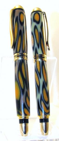

That blank was pretty nice. It turned similar to PR but it threaded much better than PR. Ed gave me a 3.5" chunk. You have to cut it on an angle to reveal any character, and you do want to paint your tubes. Even by cutting it on an angle a person could easily capture two pens from that chunk. A smaller pen does look better than a larger pen with this material. The orange tubes in the blank are more concentrated in the center than to the outside, thus a smaller pens cut closer to the center have more character. My disappointment in the blank is the sparkles. There are tons of sparkles on one side, which looks real great, but on the other side of the blank there are no sparkles at all and it looks very bland in comparison. I'd give it 4.5 of 5 stars. Definitely something that needs to be in the inventory!

The 50mm rod took some creativity to make into a pen. COMING is the bar that will yield two pens. Although I posted this before, here it is again, just for clarity.

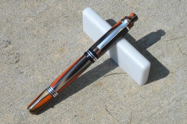

The actual tap size of the cap is 8x.75 It's not 100% perfect with that tap, but it is 98% perfect. At first it's a micro tight and after you screw it on then off, it's smooth as can be.
Ya'll convinced me..I unscrewed the finial and ground it down and re-polished the top. That's part of the greatness of this type of assembly. I always feel like the churchill clips are a week link prone to possible breakage and it's nice to be able to replace it.
The sun is going down, so my brightness and colors are not where they should be anymore.
