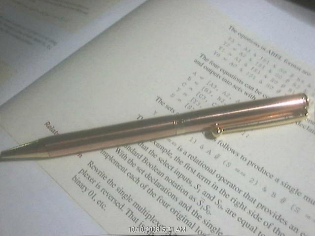

I did one with 14-2 wire. Used carbide tip tools. Looks nice with a coat of CA to stop tarnish. It makes for a heavy pen though. Not a very good pic. I did it according to the article mentioned above. If you do it use a spare mandrel to do the soldering.
