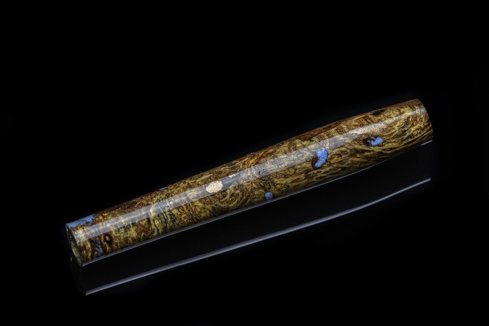

OK - updating with the progress and notes -
All attempts to get even the infiltration CA to actually wick into the 320 mesh copper, at best left a thin layer of bonded copper - but research also started to indicate that while 300-350 mesh powders are common, they can be too fine and the space between particles too small to start the capillary action needed to saturate the whole depth of the powder -
I sourced some 100 mesh copper and turquoise powders -
I picked a piece of very punky something I found at the bottom of a shallow pond - weighed very little and was quite soft and wet - I had dried out some slices of it but wasn't sure it would be useful for anything - I sliced up a blank and bored a hole for a pen tube and bonded in a brass tube -
I rough turned the blank to a little larger than the desired size - glueing back on three pieces that flew off while turning (it was just to be an experiment - both the inlay and the wood -
I filled some of the defects with copper and some with the turquoise powders - the CA instantly absorbed into the 100 mesh powders - saturating down through the powder in the voids.
Both the stone and the copper could be hard on turning tools but carbide tools didn't seem to be affected - roughing off the excess fill and glue was easy and straight forward - sanding went as normal but the inlays seem more prone to showing scratches -
The challenge seems to be getting the polish desired on the metal and stone before beginning the finish layers - I sanded down to 600 grit before trying to get a shine on the two inlay materials - they started to appear polished around 1000 grit
The polishing of the inlay can stain the wood around it but I had dripped enough of the very thin CA on the wood that the grain was partly filled and sealed - even switching to a dry polishing compound on a soft cloth didn't discolor the wood and put a shine on the inlays -
I then built up a thick layer of CA - I still didn't manage to completely fill some of the voids in the wood but its a good test.
The copper will take more experimenting to get it to look like solid metal - the turquoise powder just seemed to work without any issues.
Pleased with the progress!
Lots to continue to play with and improve - could have used a lot more care sanding the CA - can still see fine scratches but was testing new sanding materials and the whole experiment was under two hours.

As for shine are you not doing a CA finish on top?? Copper is not bright to begin with. Put it under heat and it will darken. If you put dust in both parts A and B I do not think you will get a good reaction and then get it to stick. Here is another suggestion. fill the crevices with plain dust and then put a layer of epoxy on top.( You can mix part A and B and add the copper dust and see if that work. Just need to use a longer open time epoxy.) Epoxy is the answer to what to use but the method may take some trials. CA will not work. They do this all the time in inlays when making bowls and things like that. Look for utube videos . As far as the size of the dust I do not know that one.
I have worked with epoxy a fair amount - with the powder metal, its a bit soft and seems to require a lot more care not to generate any heat while trying to put a shine on the metal - the CA just seems to be harder and clearer - giving a brighter, shinier finish.
With the 100 mesh powder, it wicks in immediately, sets in a few minutes (even without accelerator) and integrates with the CA finish pass perfectly. The slightly slower and thinner infusion designed product works even better than the normal super thin - sets slightly slower but is still water thin.
The various videos and demos I've watched seem to be split on the epoxy vs CA but folks are doing inlays with both, even up to significant size areas. Above a certain volume of material, I think that the CA could get too hot and potentially become an issue but its used as widely as the epoxy.
