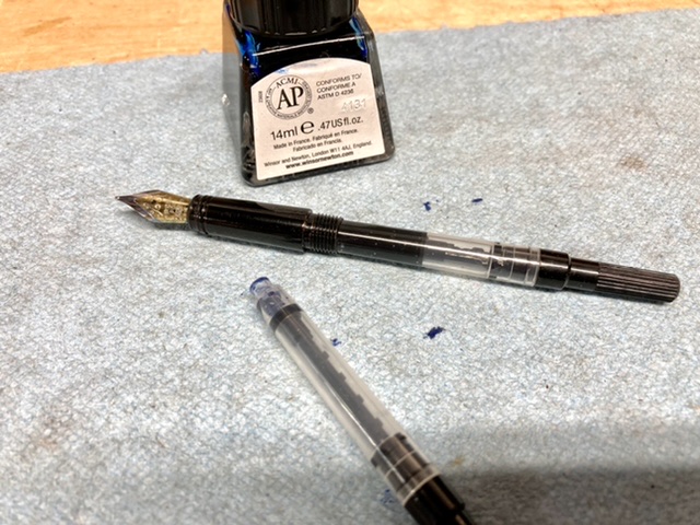

Hi all. I'm super frustrated with the land of fountain pens. I'm new to this. Specifically, it's a "tac black (caballero) fountain pen.
I popped the included SI-standard ink cartridge in and really enjoyed writing with it. The ink ran out. New adventure— I bought a bottle of blue ink at Michael's and tried the converter. Plunged the nib, twisted the plunger and sucked up some ink. It won't write. Rinse. Repeat. Repeat. Repeat. I thought maybe I was getting a vacuum holding the ink in, so I tried to press out all the air, but I'm pretty sure the nib is designed to prevent an air lock. I grabbed a new converter for another pen. Same result. Is there something I'm missing? Is there dried ink somewhere in the nib from the SIS that I gotta clean out?
For cleaning, do I just soak the whole nib in DNA? Or nib and section?

I just looked at your photo again. Your problem isn't the pen. It is the ink. The only inks you can use in a FP are designed for FPs. You are using a drawing ink which has a shellac base. This is a notorious way of ruining a pen!
According to the manufacturer "These inks can be applied with brush, dip pen or airbrush and are widely used by designers, calligraphers and artists as well as illustrators" not fountain pens!.
If you had a problem with regular ink you could use ammonia for cleaning a Fountain pen, not DNA. Do you have an ultrasonic cleaner? I use a teaspoon of ammonia in a cup of water in my ultrasonic cleaner. However, a new pen shouldn't need this. Can you use the converter to draw ink up through the nib and out again? If so, pump the ammonia solution through it. What ink are you using, Never use drawing ink in a fountain pen. You will kill the pen. If you like interesting colors I'd recommend the Diamine line of inks to use in a FP. They are available in the US.
I would call indy-pen-dance, ask them if they have a cleaner that will remove India ink. Unfortunately though I think you are out of luck. Your solution may be replacement of the section and the converter.

Unfortunately, Brian is right - the problem is the ink.
From the Michael's website:
You may be able to save the pen (actually the nib, feed and converter) by soaking them in DNA; if you have an ultrasonic cleaner, that may also help. But the key point is that these inks are waterproof once they have dried, so you can't clean the pen in water.
But the worst case scenario is that the nib and section, and also the converter, are ruined and will have to be replaced.

This is a huge relief. I don't know what prompted me to take a photo, but I'm glad I did. I'll pitch the ink I have and get the right stuff. I'm not bothered if this pen or converter is lost. It was a pen from my 'mistake' pile anyway, which is why I was practicing with it.
Thank you so much for reading and replying!

It may take some work, but you could try to clean the nib. It would be a good learning/experiment case, since it's considered trash any way.
If the ink is shellac based, you will likely need alcohol to to clean it.
duncsuss
Jun 29, 2012
2,163
Wilmington, MA
With denatured alcohol and an "ear syringe" from a pharmacy (or Amazon) you might be able to unclog it - but removing the nib and the feed from the housing is the best place to start.
Soak in hand-hot water for a while before attempting to pull the nib and feed from the housing - shellac softens with heat. Once you've got them out, use a soft toothbrush and alcohol to clean the gunk out of the ink channels in the top of the feed. (You can clean the fins on the underside too, but they are not essential to get ink flowing through the nib, they help prevent it drying up if you write quicker than the feed can deliver by storing a small amount for emergencies.)

Glad it cleaned up for you.
Cleaning, tuning and maintaining nibs is just another aspect you will need to learn as you sell/use fountain pens.
Hang on to the ink. You never know, you might try your hand at calligraphy. Or at least making calligraphy holders.
