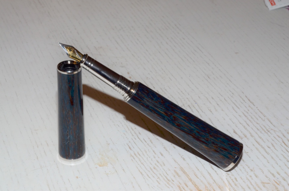

Thanks for the answer.. This is for a one off gift so if I need to swap in a longer cap tube it's no big deal.
Thanks! I'm off to place my order.

Good news is the FP nib fits the coupler. As Ed said the cap will be an issue.
To resolve this I will replace the 2.02" 12.5mm cap tube with a 2.42" tube from a Woodcradt Dugas stylus. Lucky for me Woodcraft had a tube set on the shelf.

Done! I think it looks more balanced with the extended cap.
Special thanks to Ed and Dawn for putting up with me :)
