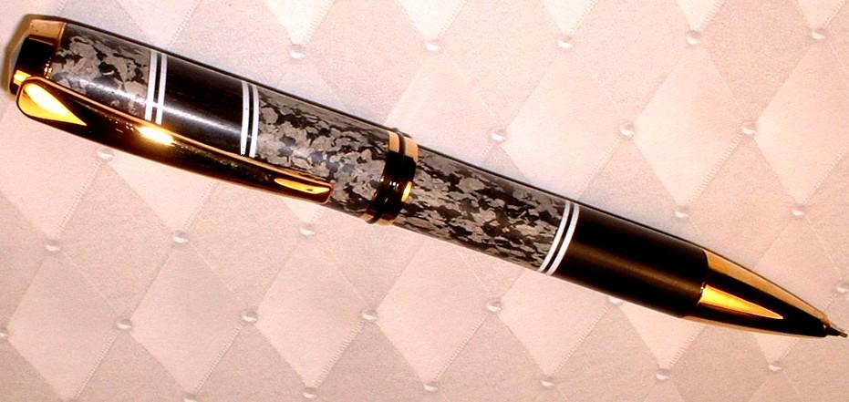

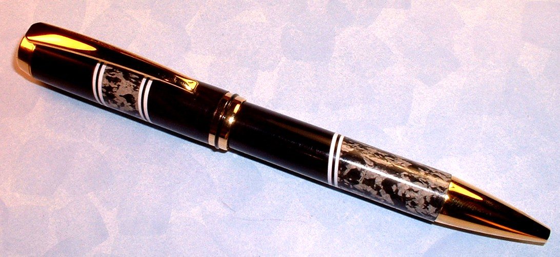

I've done a number of these with good results. Like other plastics, etc. you have to be careful of blowouts when drilling and need to take light cuts with sharp tools. Other than that, I think they are straightforward to work with, polish up well, and have an interesting look that I happen to like. I've done a few straight up, but I also like using environ in segmented pieces.
I've purchased Environ from CSUSA in the past and I think I also got a batch from one of our members. I've never tried the mainly pens site listed above.

Barry-
Those look very nice, nothing like the Environ blanks I have bought. Mine were dark and relatively solid colors....reddish muddy, bluish muddy, greenish muddy...:D
