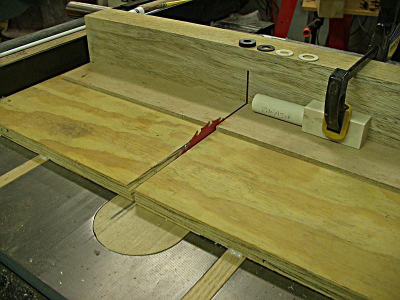

I assume this is a one piece blank needed for this kit. To be honest with you when I do segmenting like this I use my tablesaw only. If need to flatten the ends I do as I mentioned above. But I build my blank on the tube and it helps with not worrying about the joint failure when drilling. I predrill both blanks. I then cut approximately the size of the blanks needed (leaving a little extra for trueing later. If need be i flatten ends as mentioned and glue the tube in and also glue the blanks together. Not sure if this helps. here is an example and also the simple jig I use to cut my blanks to length. Using that simple jig I can cut as thin of a blank as I want. A good sharp blade is all that is needed.

If you are only going to glue two blanks together and want a perfectly straight joint, use a sled like the one John T has used above, and clamp one blank on each side of the saw blade. Run the sled and blanks into the saw, cutting a little off each blank at the same time. This will give you an even parallel surface on both blanks to glue. This is the same method used in woodworking to make perfect mitered corners on frames or boxes. I find thick or gap filling CA glue best to fill any small imperfections and make a solid blank. Anyone that has a table saw, band saw, or router should have a sled like John's in order to make straight, square, repeated, small, and ( safe ) cuts !!!!! By the way, thumb is healing well. Jim S
