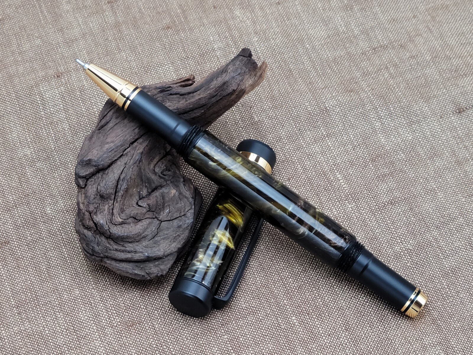

North Carolina, USA
Here is a PSI Classic Elite with a Pentel Energel needle tip cartridge in it for reference.
