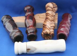

I have not been one to check "Show off your pens" very regularly in the past 2 years so I could have missed quite a few posts. However, I read many posts on finishing that mention William Young's method and no need for sanding. I have not seen a pen finished with his method with a photo up close in the "photography" section. So, what I am getting at is this: I think we are talking about two different levels of acceptance. That method may be great for achieving a very good finish - much like a very good quality piece of furniture purchased at a major chain department store. However, there is the next level of furniture that is custom made and hand finished that will be or has been handed down for several generations.
The photo of my duck calls that reveal the shine better than smaller pens do - that kind of shine will practically never be achieved by a "no sand" method. Even "spray painting" will need a polishing and waxing to achieve that kind of finish consistently.
So, what we have here is two differntly levels of acceptance - Very Good for the masses versus "I will not settle for anything less than the best". To beginners and even those who have been doing this a while, they tend to see finishing methods as all the same in the end. I don't agree, as there are two different levels. I keep a 5X magnifying loup by my lathe and check the finish regularly.
