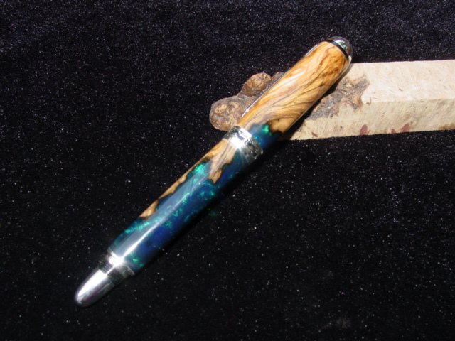

here is an example...most of us call it worthless wood
