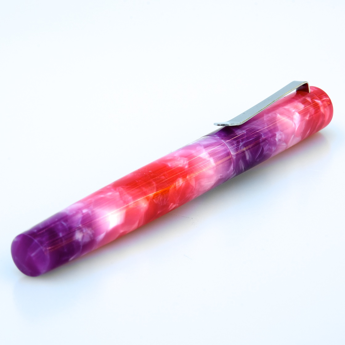

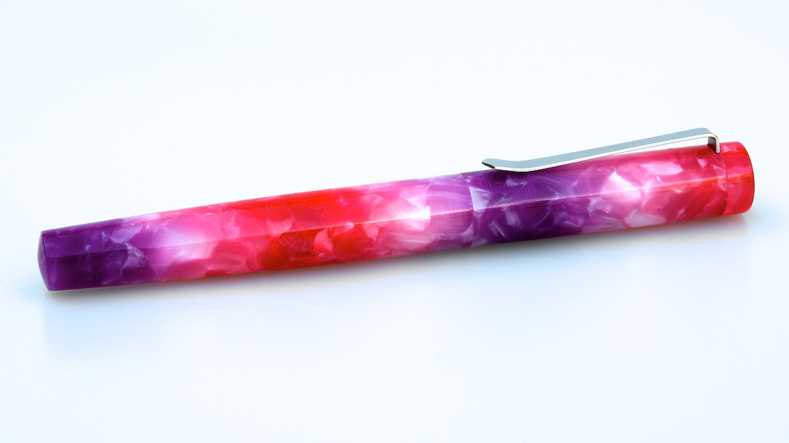

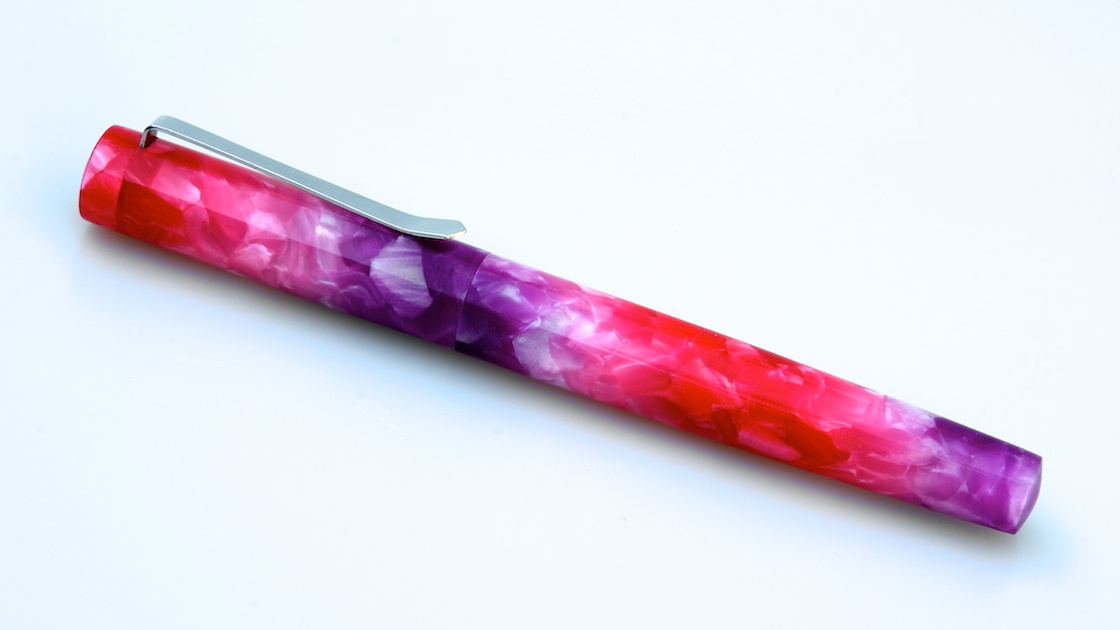

Here is a Rollerball I made for my Wife.
12mm cap threads, 135mm long capped, 125mm long uncapped, 14mm diameter, homemade stainless steel clip.
