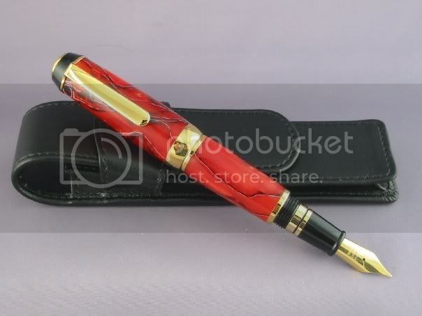

I have been painting my tubes with acrylics and celluloid’s for a couple of years now. Initially I used black paint and was happy with my results, they seemed to densify the colours and enhance the look.
This is typical of what I was getting with black painted tubes , the blank is a crimson red from Craft Supply.

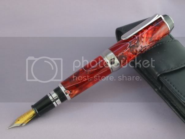

In the last year I have begun to experiment with other paint colours for my tubes, settling on white as my favorite.
Here is the same pen design, same crimson red celluloid from Craft Supply with white tubes.
I like the luminescence that the white gives in this material, and if sales is a judge I sell more white tubed pens than black.

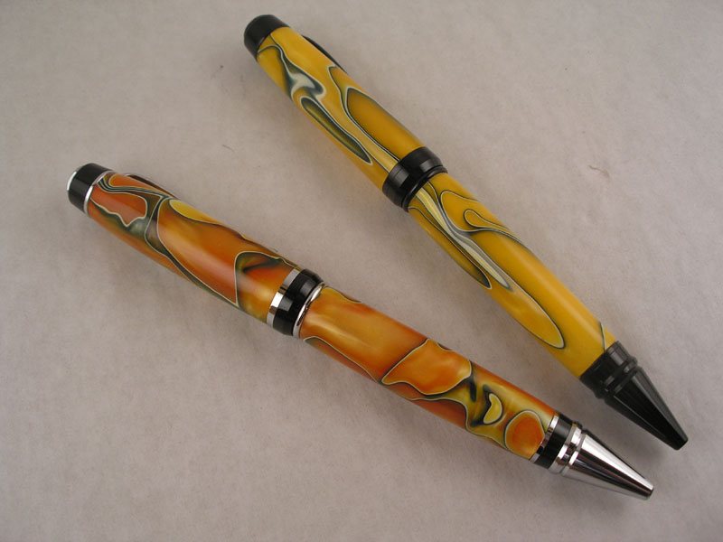

What I see Jason doing is in affect basically what I do. I have certain acrylics I wouldn't dream of turning without painting both inside of blank and the tubes....You paint the inside of the blank ands no glue bubbles will show thru! If it's a translucent paint then by all means paint the tubes too. An interesting affect can be achieved with certain of our blanks. I'm thinking primmarily of a couple oF CSUSA BLANKS Amber Marble...nice golden color with black ribboned through-out.I've painted the inside of these blanks more colors than I can renember but a couple which do are red, giving the finished pen a golden orange swirl throught-out the pen. Another that I do a lot are the white Pearl blank, aslo from CSUSA .I normally make Perfume Applicators from these so what I do is pick several neon like colors and paint the inside of the blanks with neon greens, hot pink, metallic grape, electric Blue and any others I can think of!BTW those perfumes are always the first to go!
Here's a couple of pens so you can see just what a difference a few strokes of paint will bring out both are the same material

I have tried colour matching as well with the blanks, it works nicely. The example here is to show an extreme in contrats, one picking up on the black accents in the celluloid, white to pick up on the other.
