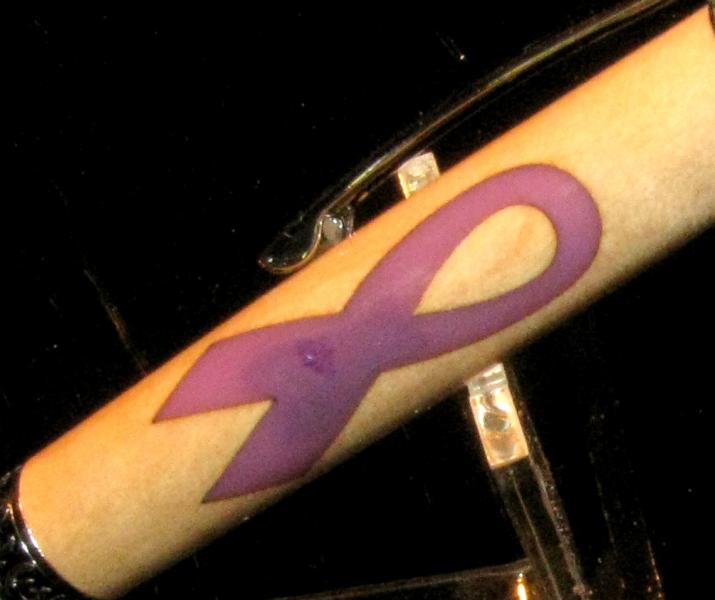

As part of the Cancer Awareness Project, I want to make a video showing how to eliminate the wooden ribbon and fill the void with whatever color you wish, to create the ribbon YOU want.
Sounded easy, so I set about doing it with 5 minute epoxy and acrylic paint. Bought the primary colors and used blue and red and white and got a nice lavender--things went swimmingly. UNTIL I turned it!!
Then I discovered a few tiny bubbles that needed to be filled. Well, the color did not match perfectly, so I abandoned that path and went on to 30 minute epoxy.
In filling the ribbon, the 30 minute was more liquid and it drained out of the recess. When I came back it was very thin. So, I created a couple dams on either side of the ribbon cavity (from plastic wood--wood filler) and refilled. The 30 minute epoxy dried and I turned it. The center was "mushy". And there was still ONE bubble, which I attempted to correct with a felt tip.
All-in-all, I am not happy with the results.
Does anyone have a "sure thing" way to fill a cavity of this size? Or even a great theory that I can use to experiment??
Thanks to all who contribute input---I really want to get this on YouTube, but it has to work without "gimmicks"!!
Here is the pen I finished--the center is a different shade of lavender--not an acceptable result.

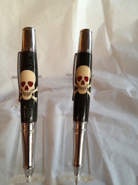

Have you thought of crushed stone/powder? The drawback is it will take quite a bit of it for the ribbon. I used crushed stone on a skull and cross bones where I replaces the black eyes and nose with crushed red stone.
