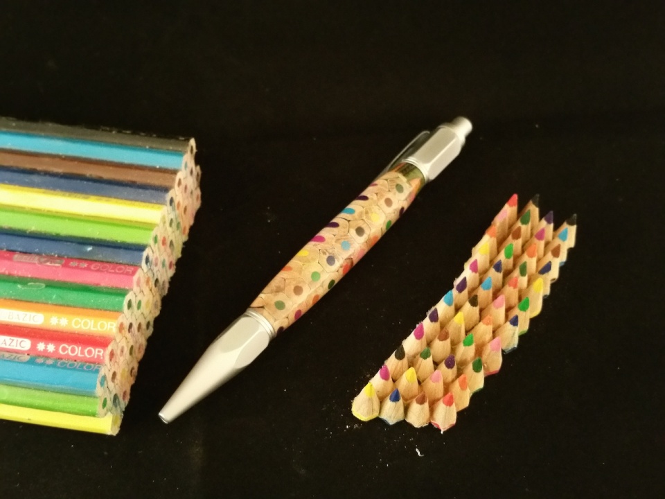

i have seen people make rings,bottlestoppers and bowls out of colored pencils but has anyone tried to make a colored pencil pen? i think i may give it a try. any tips or tricks that might help?

One of the members in the turning club I go to has made several bowls using colored pencils glued together.
His advice to anyone considering it was "use really sharp tools -- do not attempt to sand or it will smudge the colors all over the place"

There are have been several here that have made pens with them. Some glue them with CA, I like to cast mine in Alumilite. Some approach them in a cross cut manner, I like to apply them at a 45 degree angle. Make sure to use lots of CA or expoxy when gluing in the tubes, and paint the tubes so the brass doesn't show between the pencils. Expect the colored lead to come out of the pencils as you are working them. They glue in easily with thin CA. Also remember to wipe the blank down with denatured alcohol after your done sanding it to finished size, to remove the colored lead from the blank prior to the CA finish. Good luck!

They are a p.i.t.a. I find - but satisfying when finished. I got a real sense of achievement after a few failures. Trying to make a second one and now wondering why! Patience, very sharp tools and a few gallons of super glue.:laugh:

Use hexagonal colored pencils instead of round. Use about 1 1/2" length on the pieces, so you have something to cut down to 3/4 square. Also easier to hold onto when gluing. Coat them with lots of CA as you assemble and as you turn. I've seen some real nice ones. Good luck!
