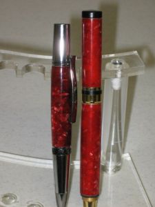

These are the same blanks. The one on the left is painted black inside of the blank. the other is painted red, You can get different looks by painting the tubes or inside of blanks. Hope this helps.
