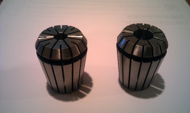

I've been looking into a collet chuck myself. So I ordered the Beal collet chuck this morning by itself ($89.00 after shipping) after reading many recommendations. Then I ordered some er32 collets from Discount tools @ $8.95 ea. (I saw the link in the posts here) then saw that they are in Huntington Beach CA. about 20 min from me. I called & asked if I could pick them up instead since I was going to WoodCraft in Stanton just 3 miles from them. He gave me directions but 2 of the collets were out of stock & would take 4 weeks to come in. He said he had another source in Chino but they would be $11.95 ea. I said go ahead & send them & he said they would be shipped today & at my door step tomorrow. Beal sent a notice that the chuck has been shipped. The Quality looks as good as I've seen anywhere.
Precision ER32 Collets
http://www.bealltool.com/products/turning/colletchuck.php
