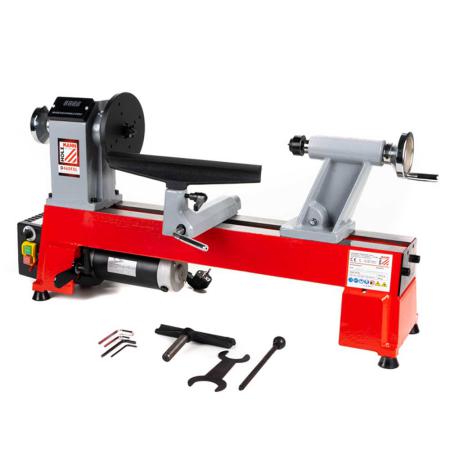

i work on a small/midi Holtzman woodlathe eqquiped with a 33m spindle. I am willing to pay something extra if a particular part is worth it; on this occasion i am not sure if a high precision chuck on a woodlathe makes any sense.
