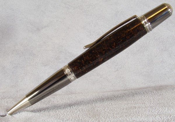

I think this is my best coffee blank so far. It is dark french roast coffee beans ground on the coarsest setting and then sifted to get out the real fine stuff. I cast it with Alumilite in 3/4 inch PVC about 2 3/4 in long.
After about an hour it was still not cured all the way hard (maybe because it is only 64 degrees in the basement and such a small amount of Alumilite). So, I heated the oven to 150 degrees and turned it off and put the blanks in. After another hour they were still not cured and I left them there.
Shortly after that my wife (not knowing the blanks were in the oven) turned on the oven to 325 degrees. When it was up to temp and she was putting whatever she was baking into the oven she found my PVC tubes. At that time they were very hot and I assumed ruined. But, after cooling they were completely hardened and turned great. I'm not sure if this is a manufacturers approved way of curing or not, but it works.

That looks fantastic, I think you've got it. Same one to one ratio?

I did use the 1 to 1 ratio of coffee to Alumilite.
I was wondering how to make it look like coffee with cream, I will try painting the inside of the blank white and see what I get. The other thing I thought was coloring the Alumilite the color of coffee with cream, but I have no idea on how to do that.
The idea of a seperate band of sugar is great. I wonder if I could cast sugar in about an 1/8 inch thickness and have it still look like sugar?

as for the sugar, cast the whole thing in coffee and then while your turning, try cutting a grove and filling it with CA and sugar, using the 'inlay' technique. that might just work.
just a thought. i just finished my first inlay of used coffee grounds on a pen. looked great. i'm gonna have to post a pic of that one.

I'll have to try cutting the groove and fill with sugar and CA. I tried to cast about a 1/4 inch layer of Alumilite with sugar in it and it turned out terrible as the sugar disolved.

I just picked up a couple pounds of spent grounds from my local Starbucks with my morning coffee. Unfortunatly, they are fresh and soaking wet from the machines.
I'm just going to assume I have to have them dry before casting, correct?

Yes, Alumilite doesn't like moisture.

Curing it in the oven didn't smell too bad. We didn't even notice until she opened the door and then there was just a mild odor.
I put it back on the lathe and cut a groove and tried the idea of CA with sugar and it didn't work as the sugar turned clear. Next I tried white acylic paint with the sugar and it is drying now.
